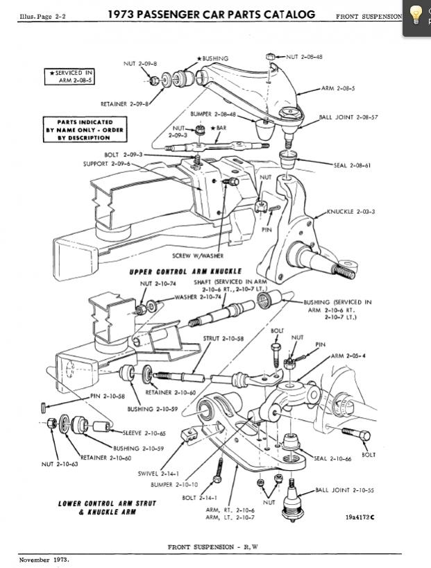

73 and up BBods use a completely different upper control arm setup than 72 and down years as the upper control arm assemblies are bolted to the ISO K member.
If you are having issues when hitting bumps and causing the car to be all over the road when driving, I would inspect or have inspected the suspension including the ISO bushings for damage or wear. If everything appears to be in good condition have it alligned by a reputable shop. The wheels and tires unless severly worn or damaged or severely under or over inflated should not cause that much of a drivability issue IMO
Sounds exactly like the problem I was having with my 74. All over the road especially on rough roads. My ball joints, bushings, tie rods, pitman arm... all good and tight. I even changed my sway bar bushings and had alignment done. Still all over the road. Changed steering gear box. Problem solved. They can be adjusted on. Try that first. Mine bottomed out and needed replacing. What a difference!
