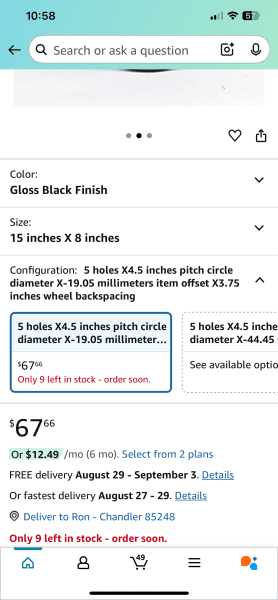

So I also need a rim. What specs do I need if I get a 275 60 15 tire? I just wanna buy a cheap new one. It’ll probably never get used or maybe once.

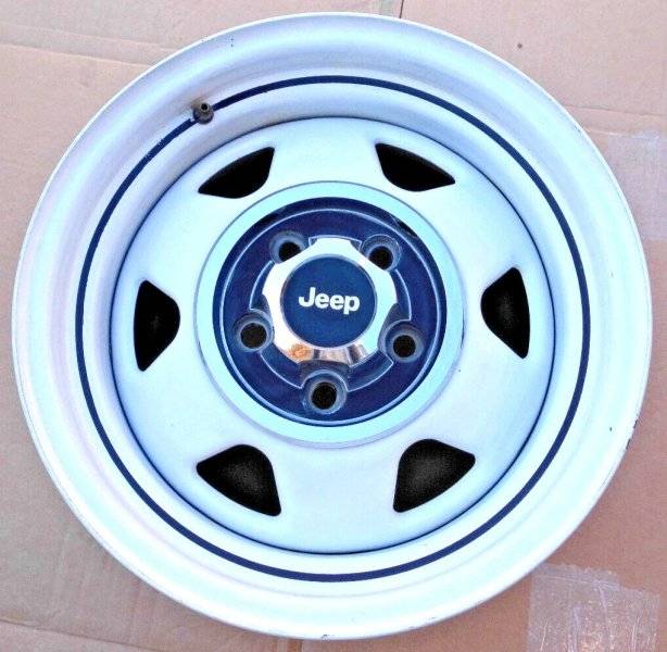

I've seen lots of Jeep steel wheels on older mopars. XJ Cherokees, CJ/YJ/TJ Wranglers, etc. Just a thought. Probably tons of them (literally) at local boneyards...
Agree with triplegreen. Probably dozens of choices in the boneyard.

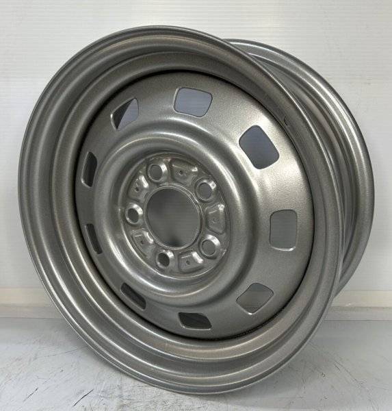

I recently bought four wheels for my trailer. $50 ea.for a 15x6 Chevy style rally wheel (NOT a Mopar rallye style!) from summit, with both a Chevy and mopar/Ford pattern. Other sizes for just a couple bucks more for wider.
I would get a 15x8 with 4.5 backspace for a 275/60.
