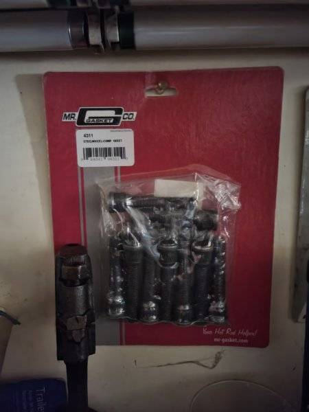

This was borrowed from another member here. A nice amount of extra length. The knurl size is slightly larger than OEM, but they pressed in just fine.
I like the MOPAR ones but the dorman ones definitely ain’t long enough. Thanks for the help it’s appreciated, I’m gonna see if I can find the MOPAR ones.

You need to know if yours are the Knurl size 0.675 as that is the size of the Milodon #86165.
Best to remove one of yours and measure.
