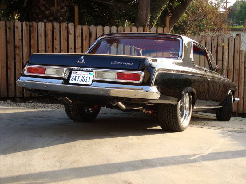

There is a 62 dart here in socal that runs a 10.5x33 out of Bob Moshers shop, but I don't know what was done to get them under there. I know it was something , because those tires are Huge! I can barely get 10.5x28 under my 62 Savoy (more restrictive wheelwell shape than a 62 dodge) and I had to move the rear end back an inch to get them in.

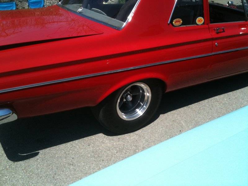

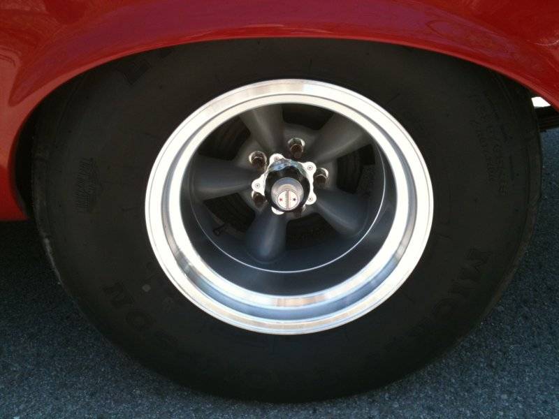

Not my car but I'm guessing a 10" rim. Took the photos for reference.
I would bet large money that the car Stanton posted has ten inch rims (at LEAST! ). The tread on that tire looks narrower than the rim, and that tire has at least 10 1/2 on the ground, and 30+" tall. I would also bet that the rear end is narrowed and the springs moved, again at least.
I will agree it looks fabulous!

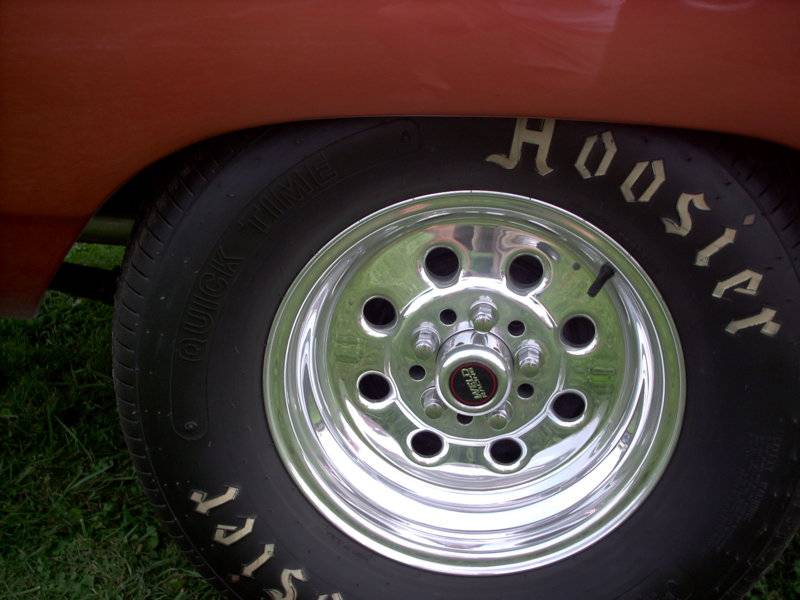

There is absolutely no way this red 65 Bel I is running a stock width axle housing with that much front spacing. That's at least 4.5" maybe 5" of front spacing. Looks great, though! Trouble also with backing plate interference with stock spring location so leaf springs might be moved inboard if running drum brakes. Might get away with no spring relocation if running disc brakes.
Also, that rim is a D-spoke wheel. AR made those so Corvette owners would stop whining about not being able to race torq thrusts on their new disc-brake equipped Corvettes. Thanks, GM. Anyway, Mopar disc brakes never interfered with the straight spoke wheels and still don't. I've got two sets of 2-pc D-spoke wheels on two of my cars so I'm....guilty.

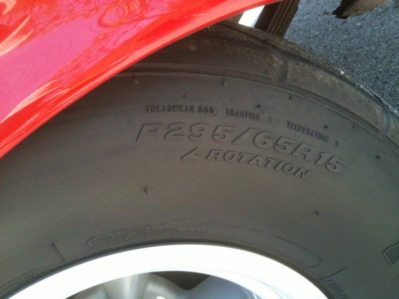

For stock wheel tubs and stock length axle from a 66 Charger, THIS is about as good as it gets. 16x9.5 rims, 295/50R16 rubber

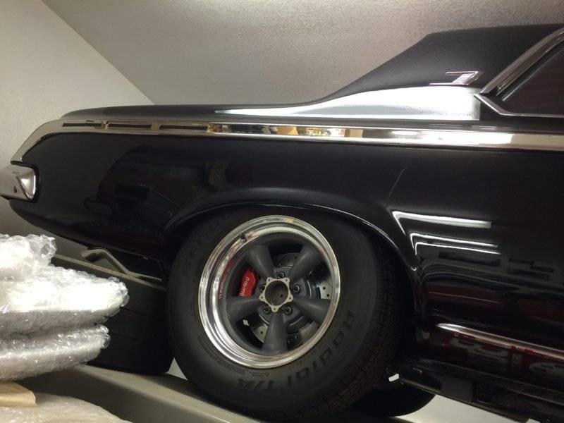

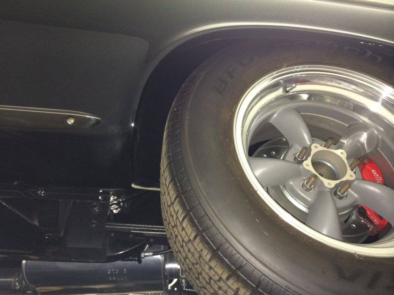

I ordered the US Car Tool replicator kit. I couldn’t help myself. I installed a set on my 64 Wagon and loved them. I’ll pay someone to do the wheel tubs, I’m not doing that again.

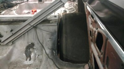

So, after seeing the wheeltubs that we’re hacked up pretty badly I’ve decided to replace them with full tubs. I’ve also moved the springs in. I’m swapping the rearend for a narrowed Dana I have... what is the max Drag Slick size can I fit under there without cutting the outer wheel opening? I’m hoping for a 14x32.
On my 63 everything is in stock location. Springs are not moved and no tubbing. I run these 30 x 9 tires in the rear and I am pretty sure I could fit a 31" tall tire in there but that's it. No way a 33" tire will fit my stock rear wheelwell. Ron

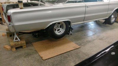

If you have the wheels and tires I you mock it up to see if you have any clearance issue now that way you can decide if you want that big of a tire on their.. not apples to apples but on my 67 Plymouth I can get a 29/10.5w tire on it now using a 12in wide wheel but section width across is 14''' something
