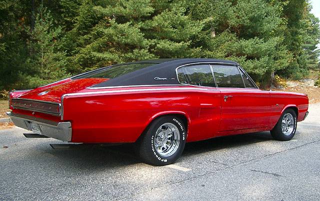

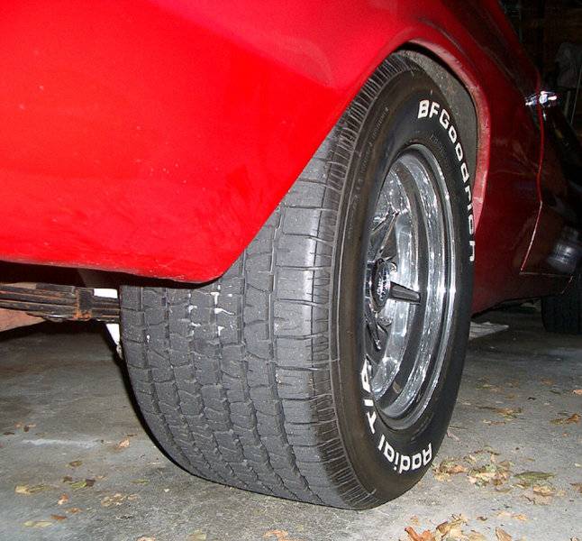

I have 295/50/15's on a 15X10" wheel.
They will rub on the inside on an uneven surface, like backing out the driveway.
Down the road they are fine.
275 60 15s on 15" wheels but dont remember the back space. No problems here.
295/50/15 on 15X10 wheel with 5" backspace (-12 offset)
I think you mean 15"x10" correct?
HAaaaaa... Dyslexia strikes again!
Your right of course... My mind was thinking about the 8" I have up front and the 10" out back, and the fingers just typed it.
All fixed...
