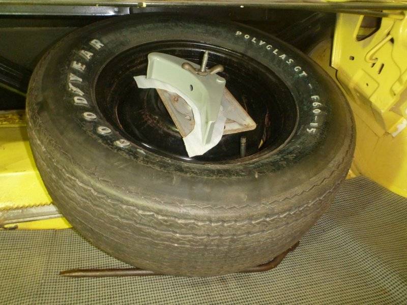

I still have the original 14X6 steel wheel and polyglass tire that my Superbird came with and it was equipped with 14X6 rally wheels.

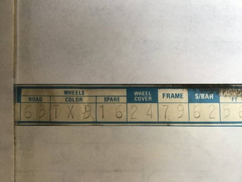

1970 broadcast sheets line 4 has a wheel code area that has “road” “color” and “spare” to tell what wheels came with the car.
here is one with different road and spare wheels.
