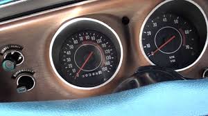

At full throttle, my parent's new '71 383 Road Runner automatic would shift at exactly 4,500 RPM from first to second and from second to third (per factory 7,000 RPM tach).
