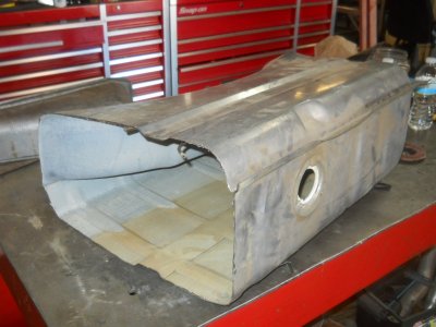

It's kind of hard to see in this picture, what I did was:
Installed an aftermarket sending unit with 1/2" pickup.
Drilled a hole in the tank above the level of the pickup tube outlet and installed a AN fuel tank bung for the return line. Has been working good- no issues or leaks.
I will try to get a better pic tonight.

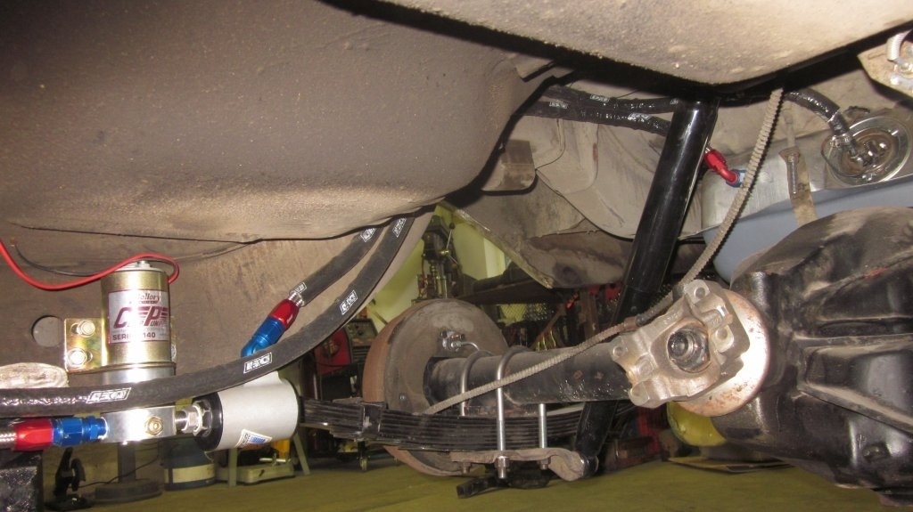

Is that pump noisy? I installed on in the Chevelle and it was very loud inside the car as well as outside. Even with magna flow mufflers you could hear it while running down the road.

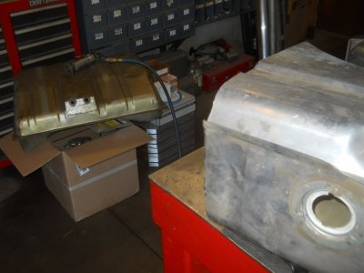

I'll try to dig up some pics
If you look closely at both of these setups you will see the return side.
FYI I have first hand experience with both and the tanks inc deal is great. You do the measuring and cutting on the return.
Also FYI aluminum 1/4npt to -6 an fittings suck I had leakage with all then I went to steel (into steel pickup) and problem went away
