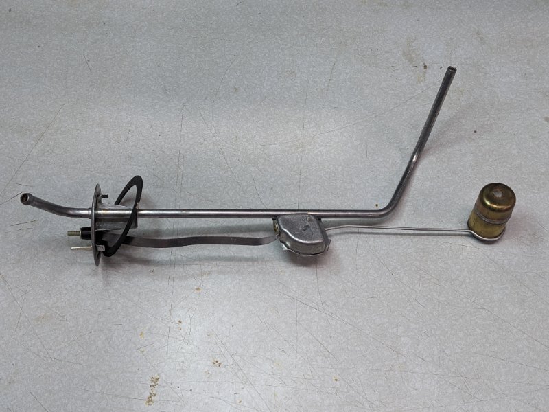

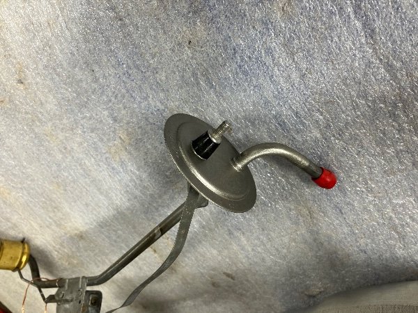

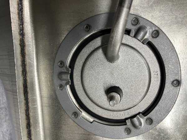

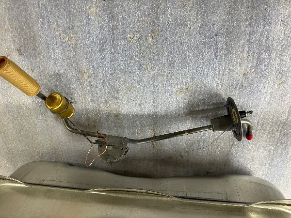

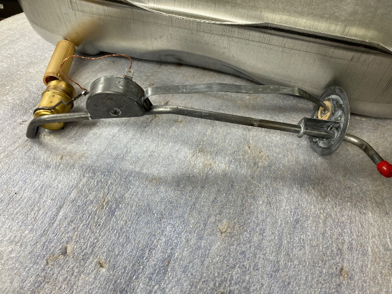

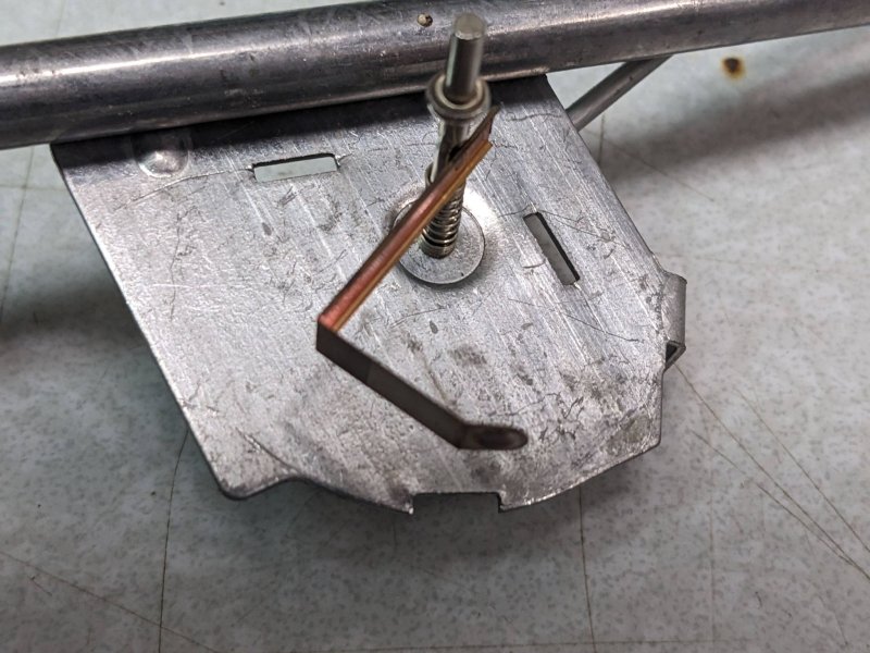

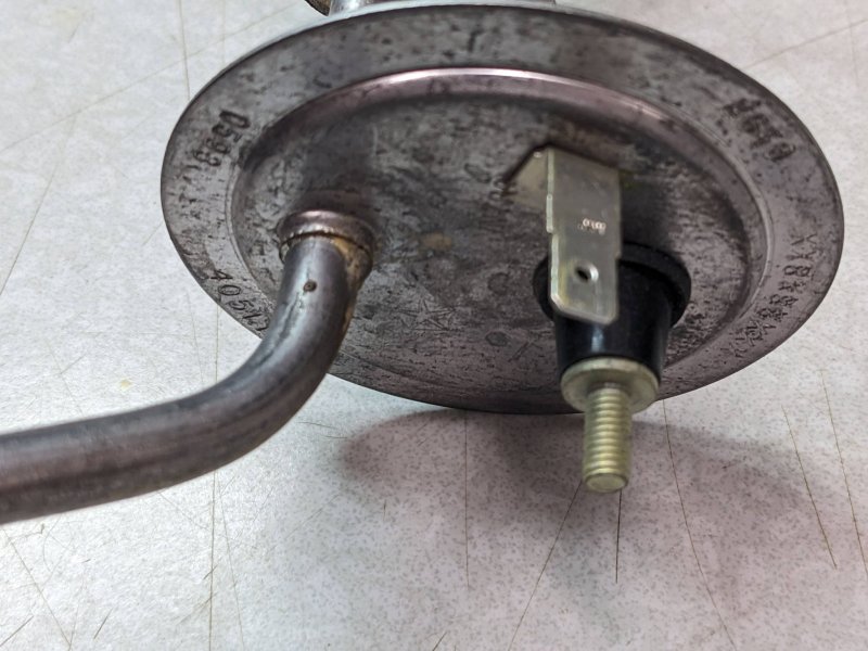

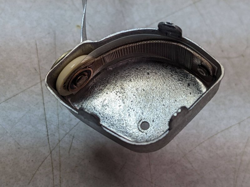

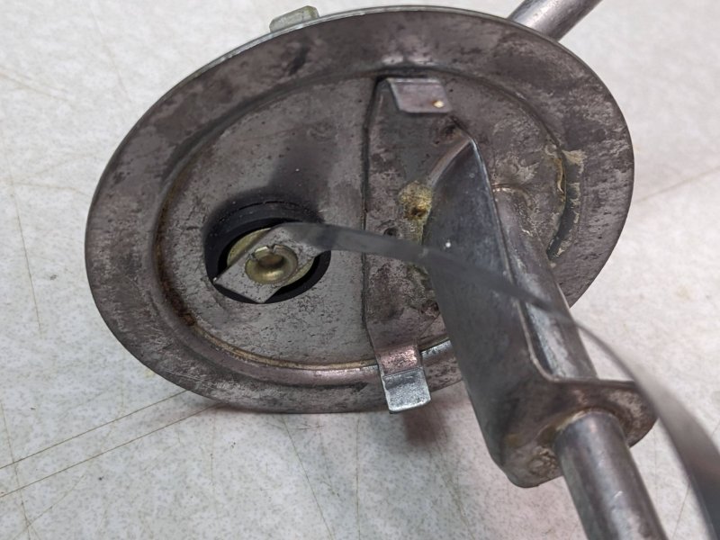

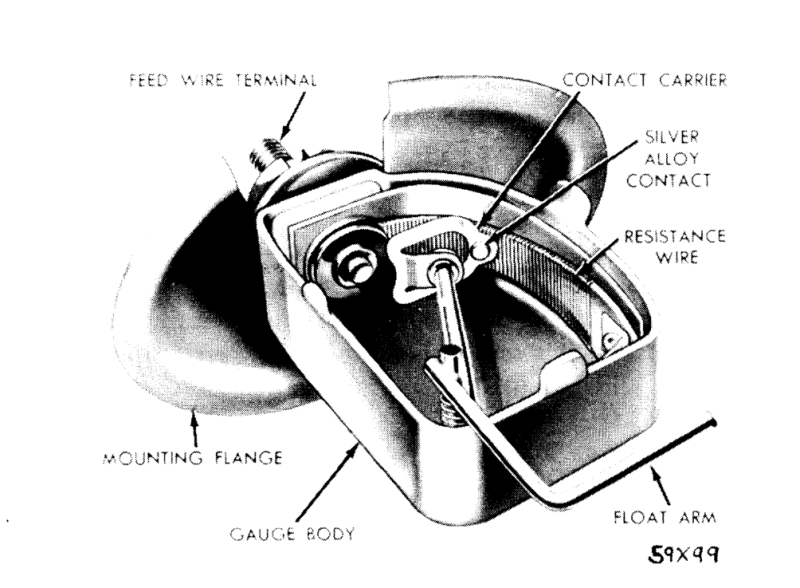

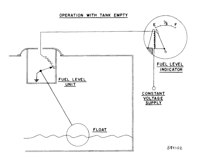

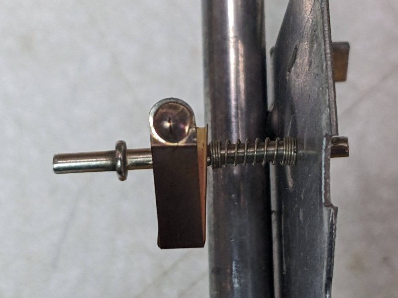

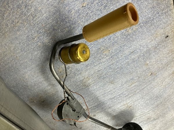

Going to try repair my fuel tank sending unit we will see how it goes
