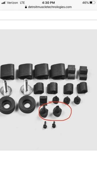

Hello, it’s been 3 years since I took this all apart, and am now can’t remember where the two bumpers circled in red go? Can anyone with a better memory then mine remember?
It might help to let you know it is a 1969 Sport Satellite.
thank you!
Maybe rear corners of the hood, they would attach to the fenders.
I think the rear bumper uses a pair like that also for when the license plate swings back to the bumper..
Those are either under the hood close to the cowl or license plate bracket bumpers.

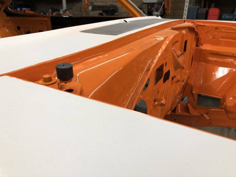

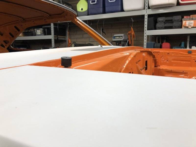

Thanks for the quick responses, my first thought was under the hood, but I think they are too tall (see pic). As far as the license plate, I think those are the three smaller ones included in the kit.
The picture in the 8th posting is not the correct bumper for that location. The rubber bumpers are unique to the year model and application. The rubber rubbers as pictured in the 8th posting are more than likely for the 70 to 74 E and 71 to 74 B rear of hood, either outer or center location. The 66 to 70 B hood at the cowl is much smaller and the shoulders of the bumper have a radius to them. The larger round bumpers could also be for a 68-69 Dodge B except Charger which uses a shorter height bumper as used on the deck lid application.
Did you purchase a complete body bumper kit or was just a hood bumper kit? The bumpers posted in the first picture is a mixture of both the complete kit and a hood kit. Not knowing whose kit you are using, but the rubber bumpers that we reproduce have the factory part numbers molded into them where applicable. If your bumper has a part number molded into the piece, what is that number?
I purchased a complete bumper kit from Detroit Muscle Technologies. There are no numbers on any of their bumpers. Their kit did include two smaller, more rounded bumpers that look like they would fit better in the post #8 pic. Maybe DMT includes it in order to have one kit cover a wider variety of years/models?
From your first picture, it appears that the kit is for a 68-69 Plymouth B-Body due to the deck lid bumpers as pictured in the top right corner of picture number 1. From your post number 11, it sounds as if you have figured out the rear of the hood bumpers. If you look at the back of the bumper, either slotted or a round nipple will help in locating some of the locations for you if your not sure.
