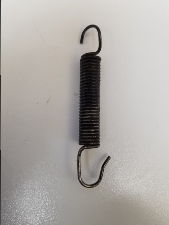

Hello everyone my project is finally going back together when I removed my steering column this spring was just dangling near the brake pedal brackets for the life of me I can not figure out where it goes at this point I was assuming that the factory made a mistake It is a 67 GTX ?

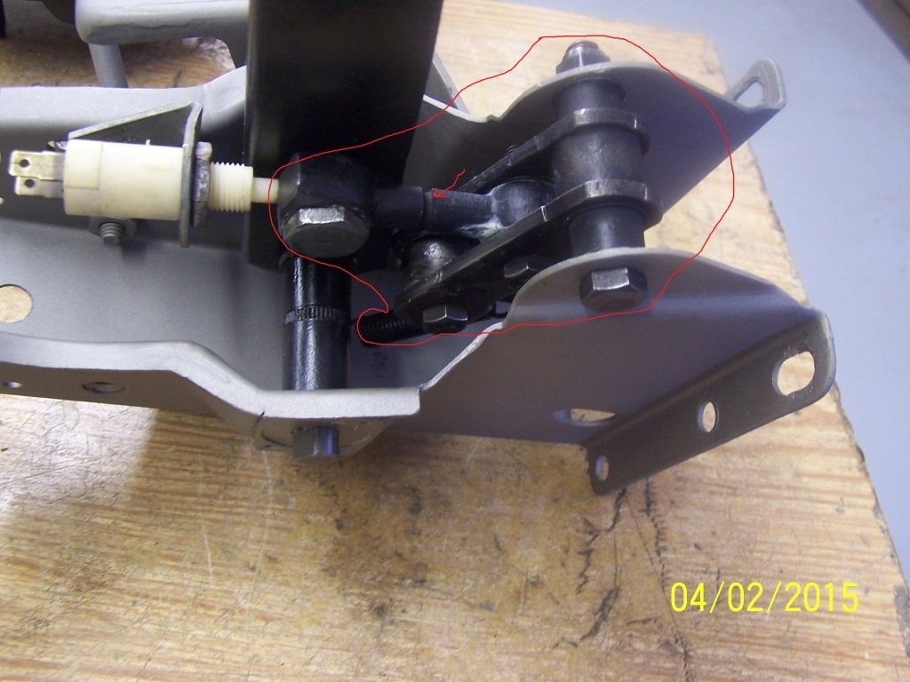

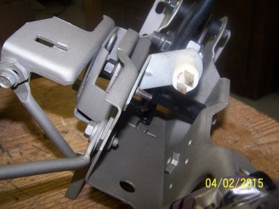

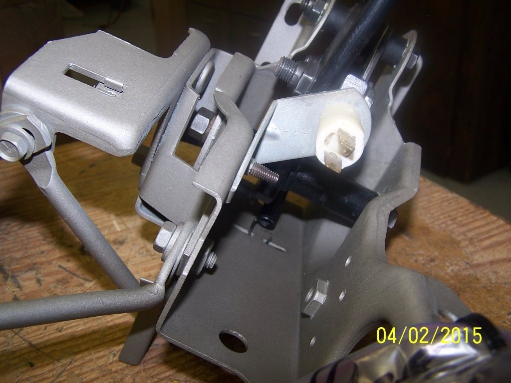

Here are two pics showing where that spring goes. It is an anti rattle spring. It serves no other purpose
I do not have that style I have the hemi style booster with the flat style bar not the rod like that
