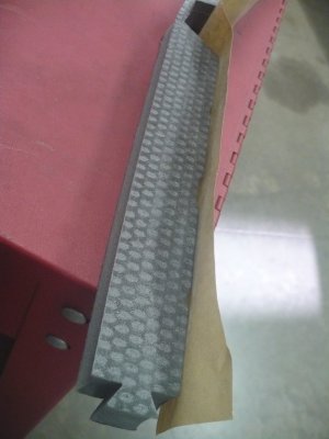

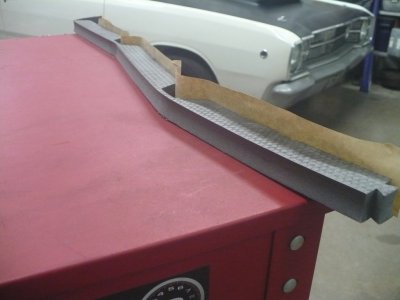

I used outside closures used on metal buildings. Cut to length and glued in place. I was a little concerned if they would hold up to the under hood temperatures. I tested with a heat gun before installing them. No problem!
Thanks, any pictures of this stuff you're talking about or a link?
Any business that sells metal perlins, sheets, etc. Down here we have Metal Mart, Mueller, Butler Buildings. If you can't find any let me know. I can mail you a couple pieces.
BTW. It's 1"x1 1/2"
