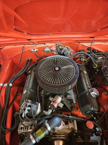

Stupid question but where do I check the transmission fluid? 4 speed
Stupid question but where do I check the transmission fluid? 4 speedView attachment 1644344

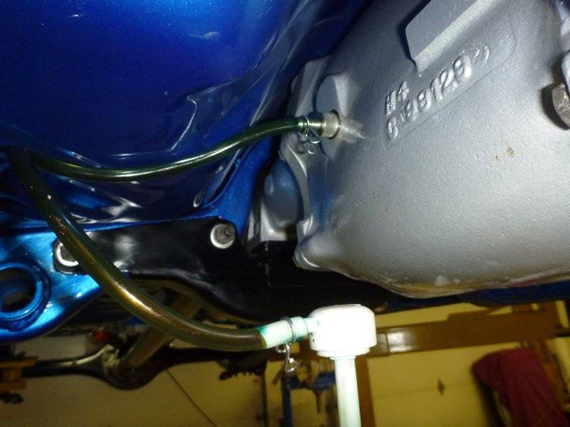

There's no dip stick......it's all underneath like the previous couple of posts. Fill the trans like you do the rear end.....when the oil starts to spill out of the fill plug, it's full. Just let it spill out until it quits or about to.....
