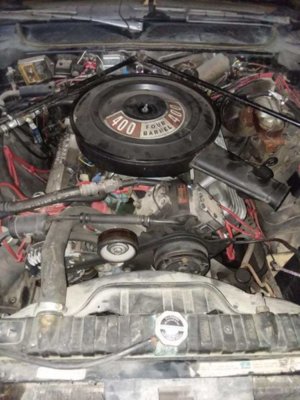

Bought a 74 Satellite last year and has tons of aftermarket wiring thats not really hooked to anything anymore. They put in fuel injection and took it back out but left most the wiring ect. This winter I want to clean it up and take out whats not needed and get it back to the basics. Just wanting to see some good pics of under someones hood to get a better idea of what Im shooting for. Thanks.

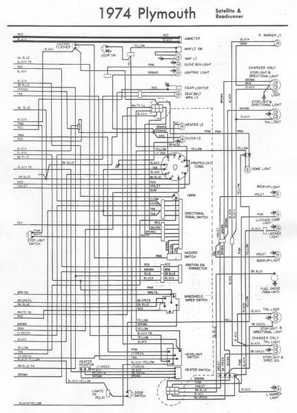

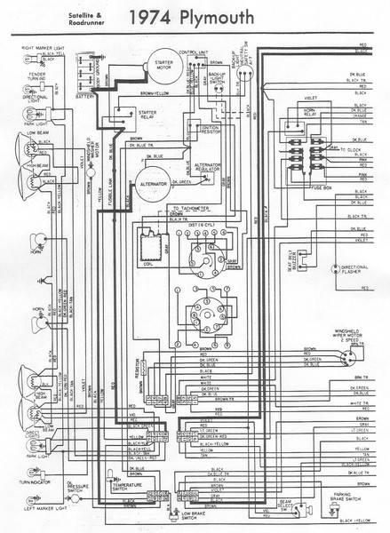

Start by downloading the Wiring diagrams..They can be found HERE. These will show you what you need and don't need under the hood. Typically there are 2 harnesses that are used under the hood from the bulkhead connector. 1.Headlight harness 2. Wiper motor harness. One or both of these harnesses contain the wiring for the ignition as well.
Yeah I printed those off. My engine bay just seems so full compared to a lot I see. I think this winter Im just going to disconnect one at a time and see if it still runs and go about it that way.

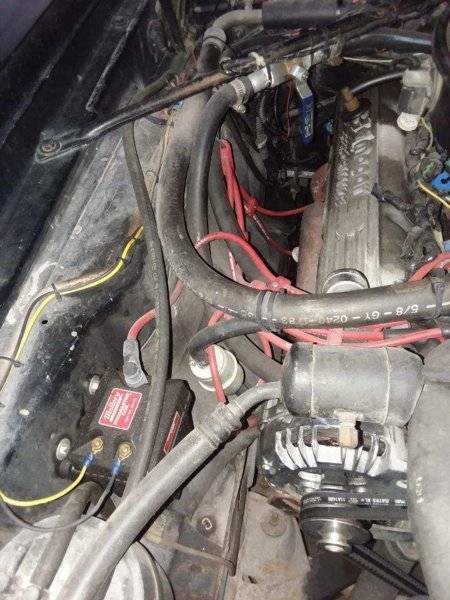

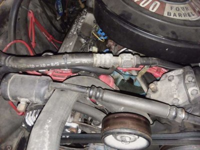

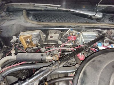

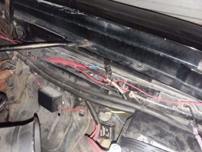

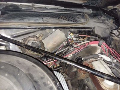

Resized952019100695163255955020 - Copy.jpg Resized952019100695163217957843 - Copy.jpg Resized95201910069516322395729 - Copy.jpg Resized952019100695163233956364 - Copy.jpg Resized952019100695163238951989 - Copy.jpg Resized952019100695163242954380 - Copy.jpg
Looks like you have a mallory ignition setup. Probably need a bunch of that stuff to make your ignition work. However if you plan on just going back to stock style ignition setup you can probably weed out a ton of that stuff. There is very little wiring needed for the Stock mopar ignition.
View attachment 846110 View attachment 846111
those are incomplete for 74.... Mymopar diagrams are not really correct for all years and models, sometimes working just as reference
Thanks. I wonder how big of a difference Ill notice by going back to a more stock ignition system?
