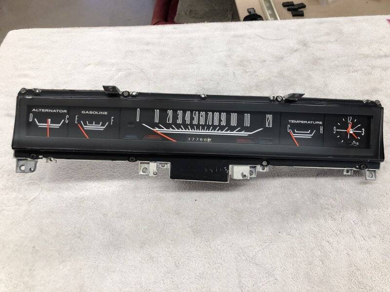

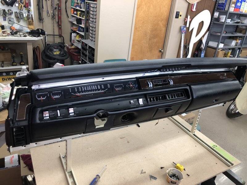

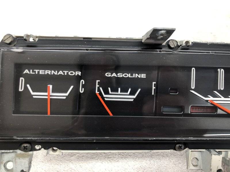

Good morning, I thought I would let you know how it all turned out.....Got the gauge cluster back together this week. Overall it turned out “okay.” I had some trouble with dust specs when laying down the black on the faces. I am not sure if it is the pollens in the air this time of year or what, but I had to redo one face 4 times to get it clean. Next came the white. Once I got the hang of laying the stencil down correctly, they were actually fairly accurate. I did airbrush on the white paint and made sure the edges were pressed tightly but still got a little bleed thru on a couple corners.
Like I said, they look good enough that they aren’t distracting, in fact they match the other imperfections in the dash, but having gone through it once and if I were going to do it again, I would send the gauge face plates off to be silkscreen printed.......for $300 they are supposed to come back looking perfect.
He is how mine turned out....
