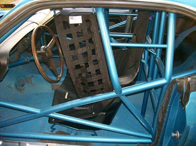

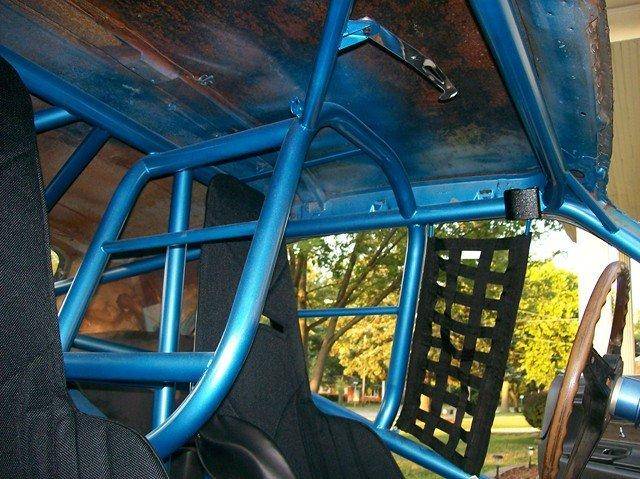

I adapted one to my original Challenger steering wheel but with a home built tubular column. Also used my original seat belt buckle for the window net for the purists.
