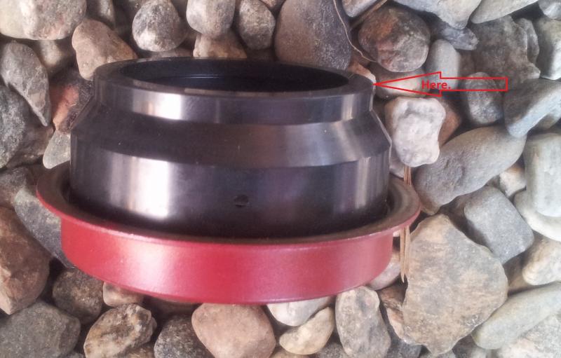

Hi, i am about to measure for my new driveshaft wich is going in my -65 Coronet and im wondering how far to push in the slide yoke before backing it out 1 inch?
I would say push it in so it lightly touches the dust boot and then out 1 inch (see arrow in the pic).
And as far as i know the correct procedure is: Car on all 4 wheels in level position, full tank of gas and 1 person in the drivers seat.
Just making sure i get this right since there is no dust boot on the old rear seal and the boot is about 1 inch long.
Thanks for the help.
