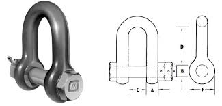

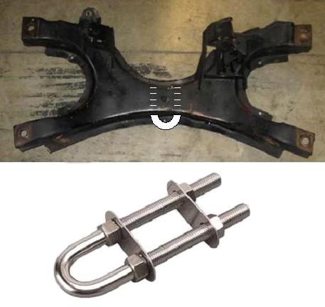

Looking for ideas on how/where to put some type of loops/hoops under the front of my 68 charger to hold it to the trailer. I guess I will just use some saddle straps around the rear axle housing., but can't think of a good way to hold the front. I hate to add even a small amount of weight to it but I'm thinking of welding or bolting some type of shackle like below to the K-frame or somewhere under the front. I know someone has a better idea. Show some pics if you can. Appreciate any help..
My plan is 3 hoops welded to the "k". Think of those shackles with the eyelets removed. Look at the hoops on an old trailer hitch or the back of a Honda.Just have to make sure the weld is deep!

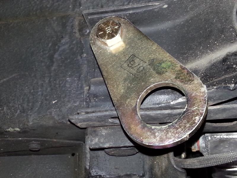

front tie down.jpgView attachment 298702I purchased 2 trailer tie down brackets from Mancini Racing and unbolted my front bumper bracket, slid the bumper bracket bolt thru the Mancini brackets and tightened down the bumper bolts again.
Litewweight and strong...and they have a hole in the bracket big enuf for your trailer tie down strap hooks.

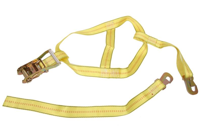

I use the summit tie down kit
http://www.summitracing.com/parts/mtd-511218/overview/
I tie the rear down in front of the axle and place my strap over top of the leaf springs and pull backwards to tie downs in the floor of a enclosed trailer. I always cross my ratchet tie downs, everyone has their own opinion.

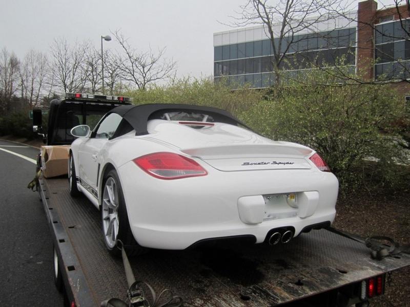

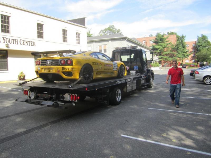

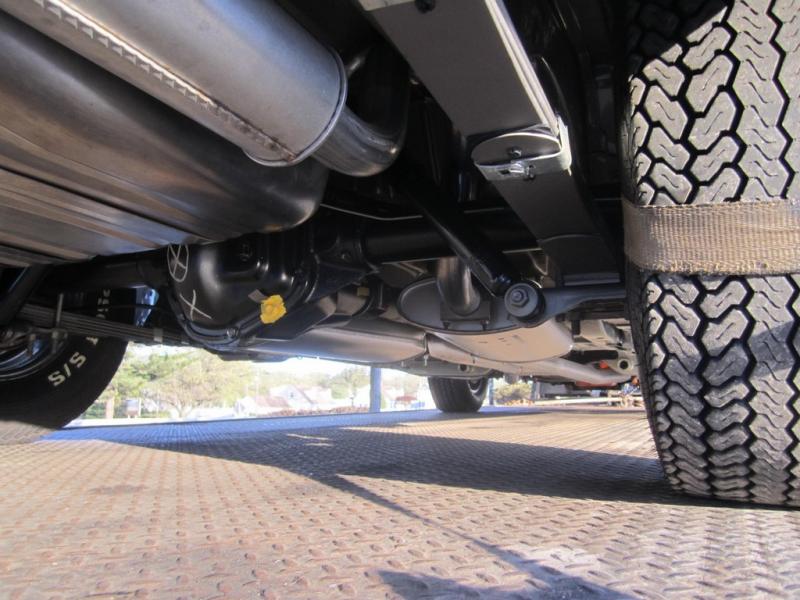

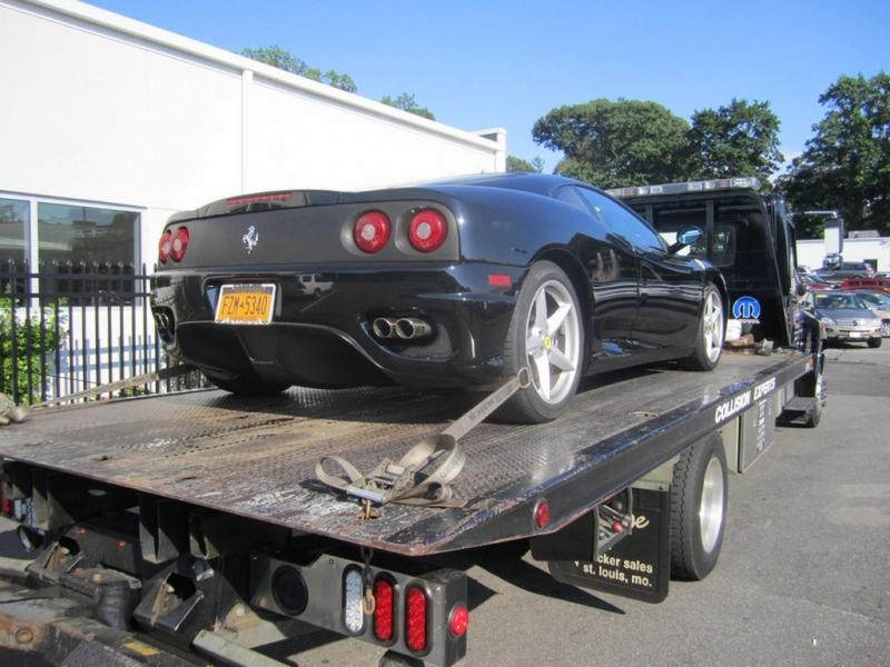

I've seen the tie down straps that go over the tires and that would seem to me to be the best method. That way you're not compressing your suspension. I would consider that for my front but I'd have to buy the tire type straps for that because I don't know if I would trust just regular straps over narrow front tires. And I'd have to add more anchor loops on the trailer so that's probably not happening. What about going thru the front wheels? I'll be running billet street lite wheels (I think) but not sure about the room between the front brake disc and wheel. Wonder if that could mess up a wheel somehow?
I kinda like the boat eye idea or maybe a hoop welded right there.

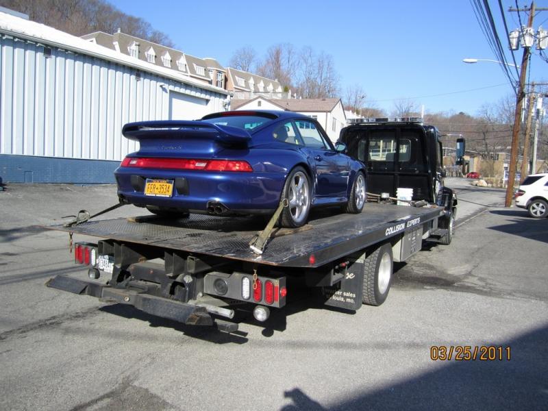

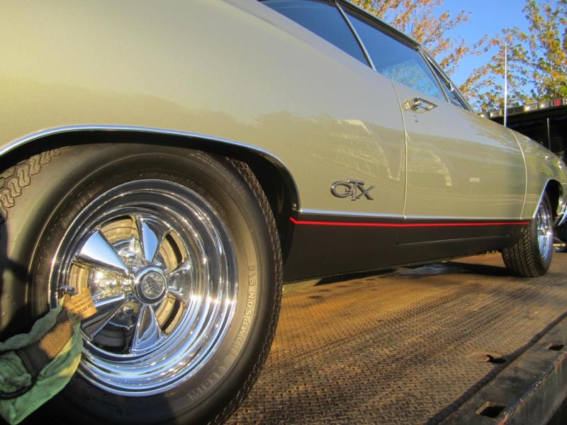

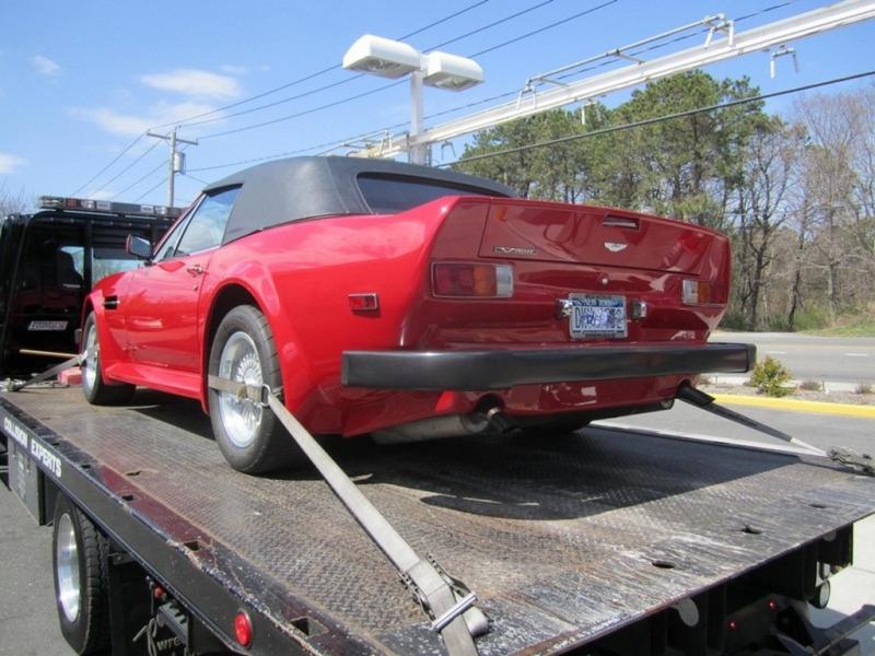

I transport many high end cars on a regular basis.Most of them I have no choice other than straps through the wheels.While driving,you would be amazed at how they bounce and the rear tires actually bounce off the deck on bigger "bumps". That why I recommend compressing your suspention a little,otherwise it's like driving your car where your going and amplifying the beating of your shocks.

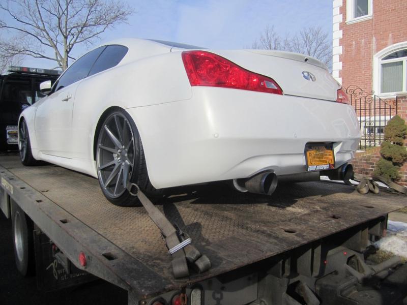

Ok I know I'm going to hear it on this one. I tie down through the wheels, thats it front and back...have done so forever and towed from the West Coast to the East every year for car events....use 2" heavy duty straps.....

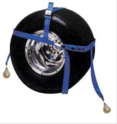

  • Towing Highland Trailering tie down wheel basket straps #1275500 $35.95 ea. Summit.jpg
