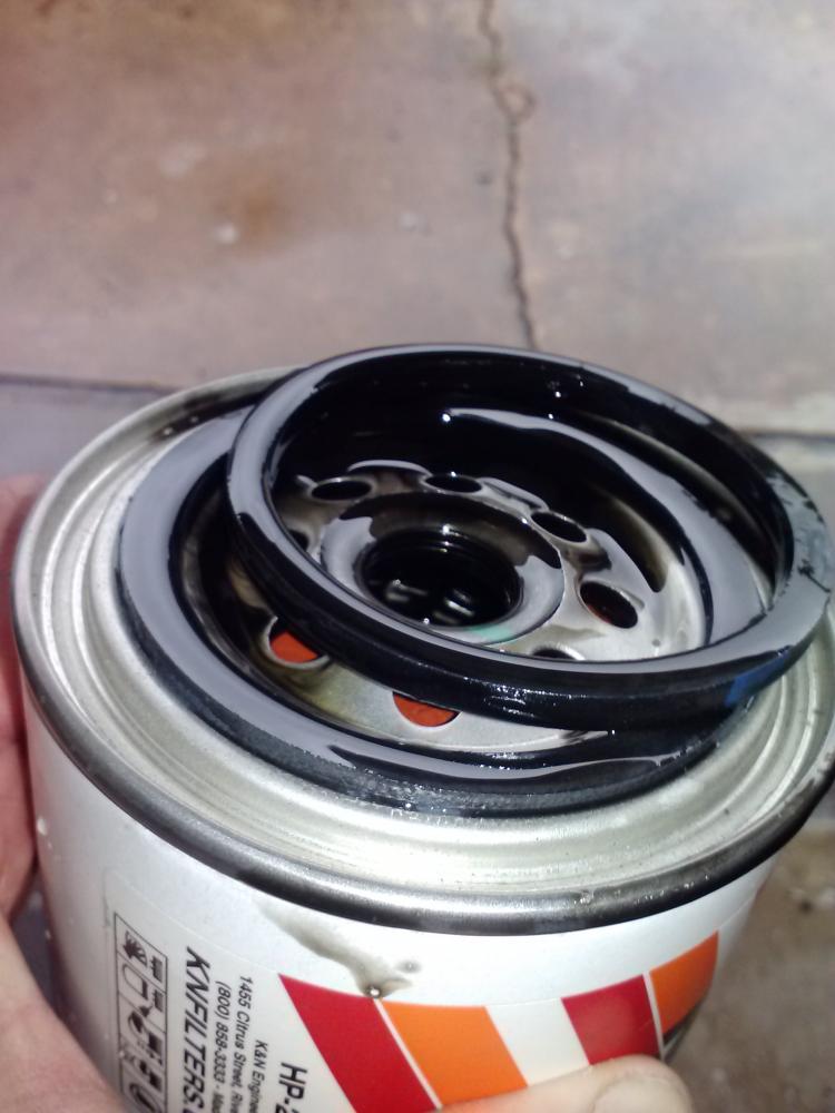

So, I just got my car back on the road this week and have been driving it a few times everyday with no issues. Last night my folks were in town and took my dad for a ride when all hell broke loose. We pulled out onto the main road and I gave it a go for about a block and oil and smoke started flying. No noises as if something came apart. Got it pulled off the road very quickly and shut it down. I crawled underneath and everything at the front of the motor is covered in oil. The block is intact there is no obvious area where it came from. My first thought was to run the oil pump with a drill and start from there. Where's the best place to start and is the any particular area that may be prone to this happening? This is on a low mile rebuilt 440 and my oil pressure was 40lbs at idle before we left. I have no idea where it was at when I shut it off but wasn't making any noise. Thanks Stew.

CAM00051.jpg. Sometimes it is that easy. Thanks guys
