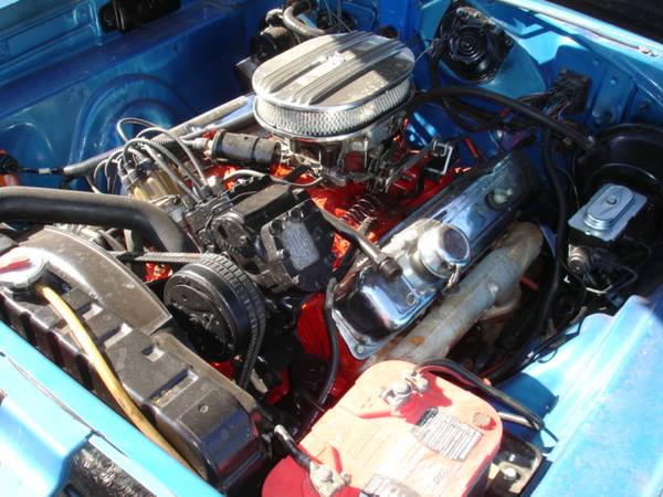

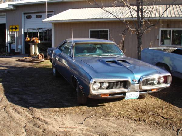

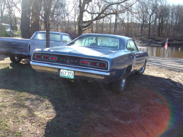

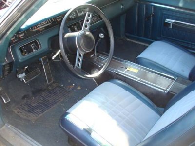

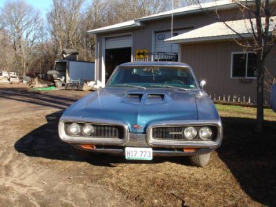

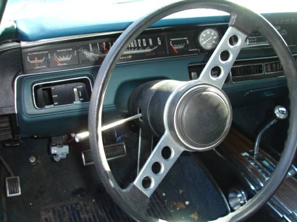

Ok, so this: http://minneapolis.craigslist.org/ank/cto/4971590302.html is something I could sink my teeth into. Thoughts/advice? See anything wrong/missing?
It has the wrong steering wheel on it. That one is correct for a 72-74 Challenger or Barracuda. Looks like it has C body exhaust manifolds on it too. C body is a full sized Chrysler, Plymouth or Dodge car like an New Yorker / Newport, Fury or Monaco / Polara.
Not that these things matter since it is apparently functional. It just matters as to whether or not you want to make this a concours type restoration or just use it as a nice driver car.
Looks like the radiator may have been replaced too. That one looks like it doesn't have the numbers on it that you would find stamped into the top radiator tank.
I would try to look at it in person to listen at how the engine sounds , drive it to see if it has any driveline / steering / brake problems and to check it our for rust and other little hidden things.
Hope this helps.

That does look pretty nice! Just don't get discouraged, I had all but given up when I found my 69 Charger for $3,500.
