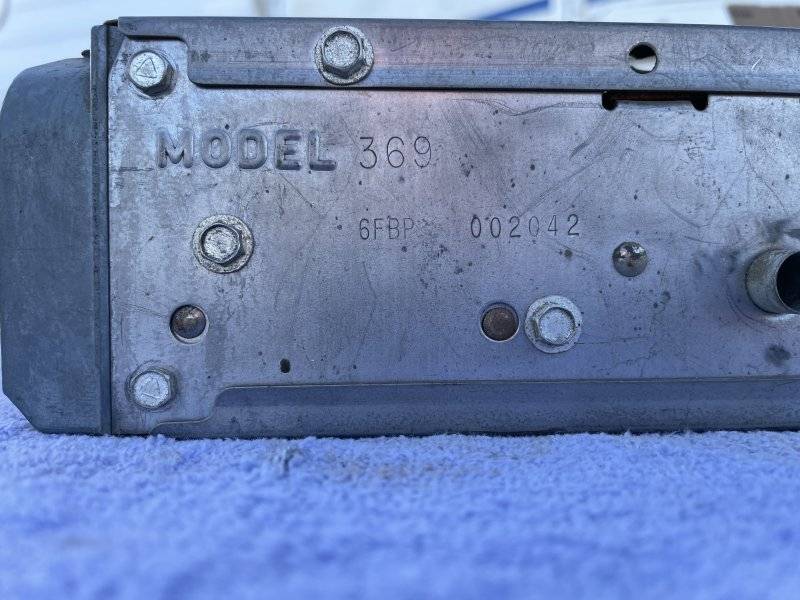

Where would you send a radio in for a thorough service? I want to replace any parts as needed and have it 100% functional. I do have a mint bezel and all of the knobs.

Those radios have disappointing FM performance. They are a AM radio that the engineers kludged a FM tuner onto in a nutshell. I generally try to talk the person into sending it off for a conversion as the FM just doesn't work that well.
What fails on these is the AM FM band switch, oscillator transistor in the FM tuner, and capacitors in various circuits. I actually bought Russian PNP transistors a few years back just to repair the FM tuners on these radios, but generally steer the owner to a conversion shop.
