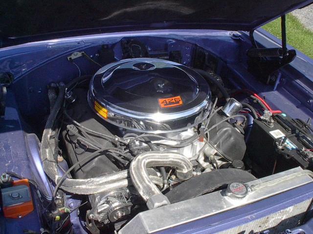

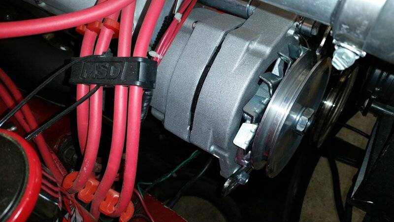

I bought a single wire GM alternator...100 amp....chrome case..at a local shop for 100 new...very happy IM000904.JPG

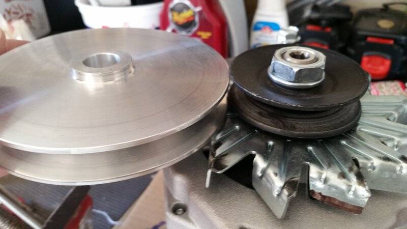

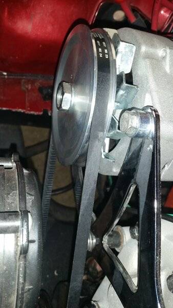

For my Coronet I just bought GM 1 Wire alternator from the local Alternator Shop for $100. I bought a couple steel spacers from the hardware store for the installation. I did replace the stock pulley with a big, deep grove, pulley just to slow down the spin on the alternator and give me a little more HP for the drag strip. Wouldn't do it for 100% street driving. I just ran a 10 gauge wire directly from the stud on the rear of the alternator all the way back and attached it directly to the positive battery post on 1 of my 2 batteries in the trunk (only because I did not know how to tie it into the key, etc, ...lol).

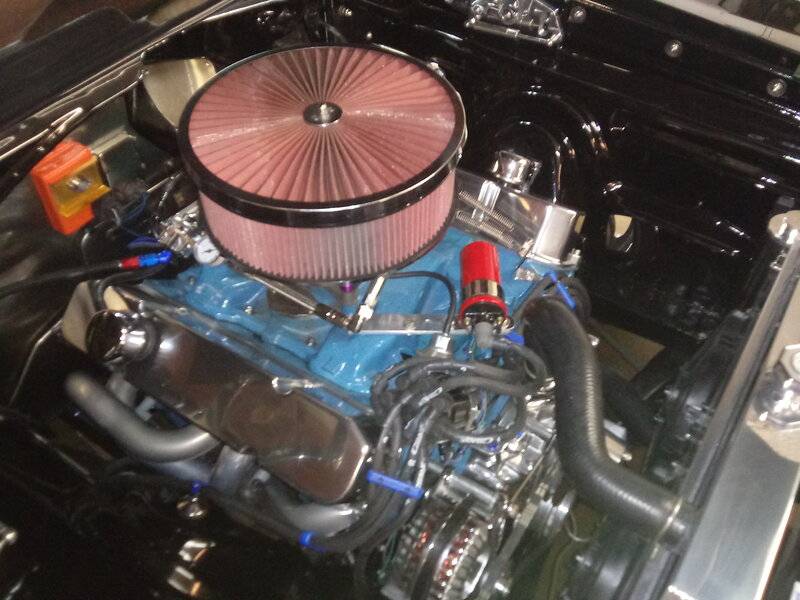

I ended up with a Tuff Stuff chrome dual field 100 amp, it connected right to my M/H upgraded engine harness made for dual. No complaints. I switch my radiator e-fans off when I make a pass at the strip to keep the hp draw down.

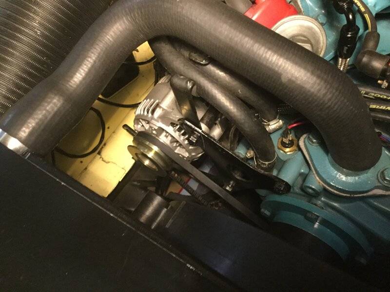

I have a racing buddy that runs an alternator and starter repair & rebuild shop. I asked his advice last year when I was having charging issues after installing electric cooling components. His advice was to go straight to a modern Denso alternator. All I had to do was rework the angle on the tension bracket, and everything bolted up perfectly. I now see 13.5 volts at idle with the fan on high and the pump running. I’m happy with the results.

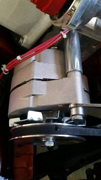

I have a question...I'm trying to hook up a gm one wire to my 400 big block can you give me any pointers?
Well...all I did was clip the ends off the field wires off and put some heat shrink on the ends then, I hid them in the factory harness. I just used the factory 12v wire that is already there to hook up to the GM alternator. It fit my factory alternator bracket after I made a small tab for the adjustment bolt. The tab bolts to the alternator and has a hole that you run the bolt for the adjustment side through. The first one I had on fit my bracket without the tab...not sure why this one didn’t. I would snap you a picture but, I have the engine out right now so, kinda hard to see how it looks when its all tore down.
