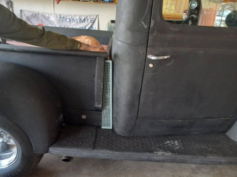

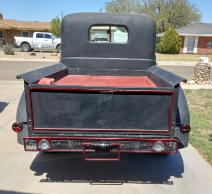

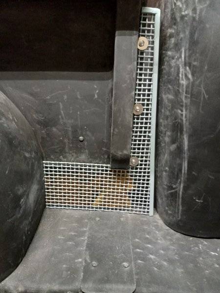

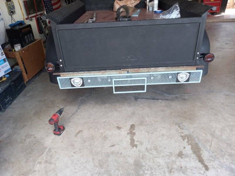

Trying something a little different for
the rear. Don't know if I like it yet as it's
just in mock-up stage.
Had some gravel screen in the scrap
pile.
Also mocked up some side close-outs
using the same stuff.
Found a set of header flange gaskets
to cover up the rough edge
cut-outs around the backup lamps.
Opinions?

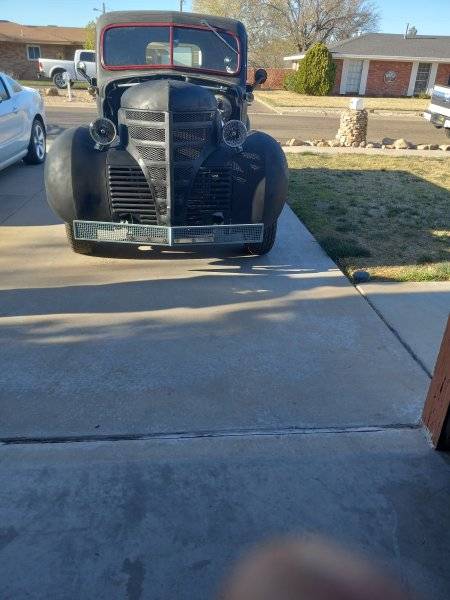

Just finished the front bumper, and
the bed close-outs. The old close-outs
had a hole for lubricating the front
spring bushing.
I don't hate it
but;
I'm not sure that mesh is right for the job
maybe look better after it's painted (?)
creative & different, light & wind/water/dust/most dirt will just pass thru
but;
I'm on the fence
guess it depends on what it is you are going for ?
& the reasoning of/for doing it that way,
or the theme of the build maybe (?)
it's thinking outside the box for sure
I don't hate it
but;
but;
I'm on the fence

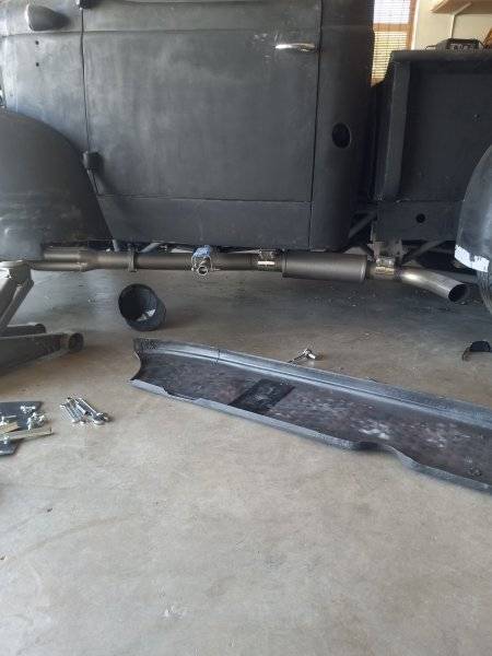

Thanks, Bud
We pointed a thermometer at that area which is where
the exhaust exits under the running board. Hot temps
from the pipes. 230 deg at fhe tips. That heat was being
trapped under the running board and cab. The heat that
was trapped escaped between the cab and bed making
inside cab temps rather warm. 165 deg even with
dynomat installed. This was during idle time and the
truck sitting still.
I'm hoping the open screens will allow most of that
heat to escape before it has a chance to heat up
the cab. We'll test again once the other side is done.
They'll eventually be painted black.
