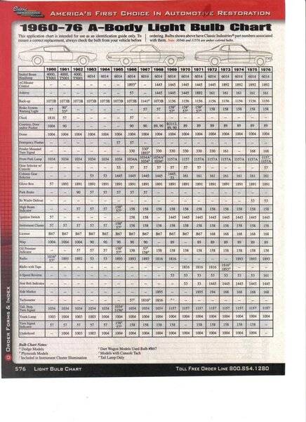

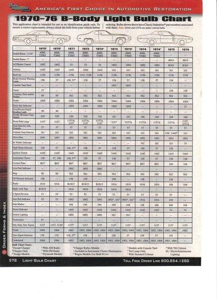

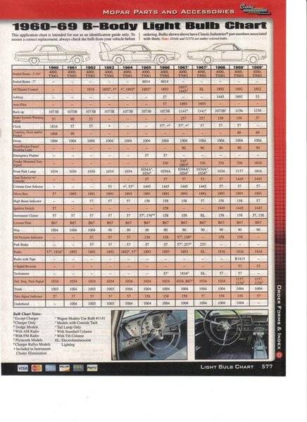

Can someone advise what bulbs the hood directionals use for the 69 charger, Can i get them at like Auto Zone or Advanced auto ?
The number of the bulb is 330. I don’t believe you are going to find them at any auto parts store. The sources for them are limited and therefore they are not priced cheap. Classic industries sells them for two dollars apiece

Are you sure.. 1873's are 28 volt bulbs. Be pretty dim on 12V but maybe that's the idea?

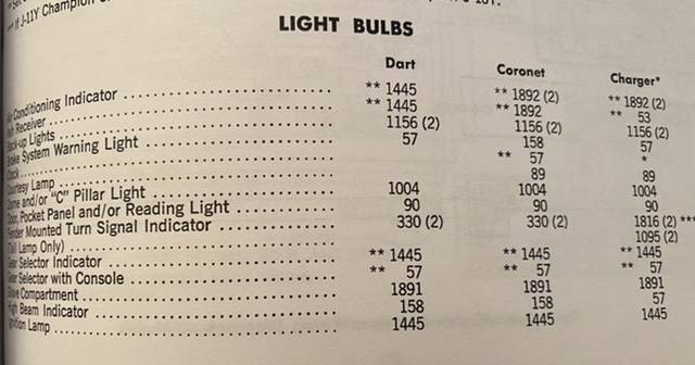

Here is the chart from the service manual.
1816 also on 45 cents at bulbtown. If you don't find it locally at some shop.

says fender mounted mines not the fender its the hood signal bulb i need i was trying to read the number off a old bulb might say 1893
Pay attention to the 3 asterisk's comment for Charger "Hood" mounted indicators
