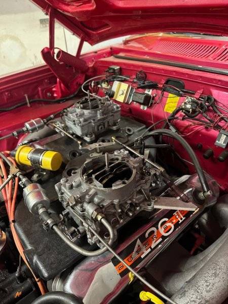

My 63 max wedge clone has the over the counter Mopar electronic distributor that has the mechanical tach drive, no vac advance. The ignition box is a light gold color. I currently have an Accel 8140 coil. Wanting to replace the coil. What should I get? It's in a laying horizontal position, I was told that's not good for oil filled???

Some guy said it would burn up, told him it's been on the car for 24 years like that. So then the question is which coil, voltage, ohms etc. The current Accel 1.4 ohms pri/ 9.2k sec. What pri ohms do I need to stay within?

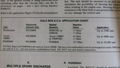

No. It is a concern with electronic. Too much current is what burns out the box ( transistor). Need to know exactly what ecu you have. Halifax has posted many times the chart for ballast and coil selection.

The current Accel 8140 with a 1.4 ohm primary resistance is fine for a Chrysler stock to a moderate level Direct Connection/Mopar Performance electronic control unit (ECU), depending on the ballast resistor used. With this coil primary resistance, a ballast resistor of 0.5 - 1.5 ohms at 70-80 degrees Fahrenheit should be used.

For a coil with primary resistance of ~1.5 ohms, use a ballast resistor of 0.5 - 1.5 ohms to keep direct current resistance at a point to limit coil and ECU, or points, current as previously described. If replacing the 8140 with a similar coil of similar primary resistance, use a ballast resistor resistance of 0.5 - 1.5 ohms at 70-80 degrees Fahrenheit. The lower resistance can yield a little more spark energy than the higher resistance.

The current through the coil and ECU switching transistor, or coil and points, is a concern for both. Select the coil primary resistance and the ballast resistance to keep the direct current to the same levels as described earlier. In the case of a 0.7 ohm primary resistance coil, to keep ECU transistor current to a reasonable level, use a ballast resistance of 1.0 - 1.5 ohms. For a high performance ECU, such as the P4120600, higher primary current can be tolerated. For a points system, a little higher resistance will be more friendly to point life. A coil such as the MSD 8202, with the 0.7 ohm primary resistance, can handle higher current levels, but the ECU, or points, are the limiting factor in primary circuit current.
