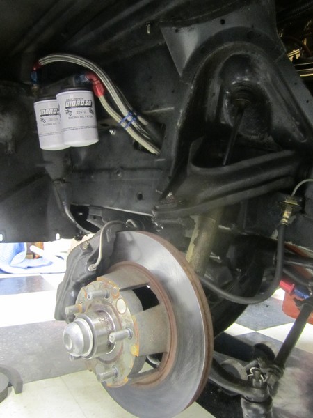

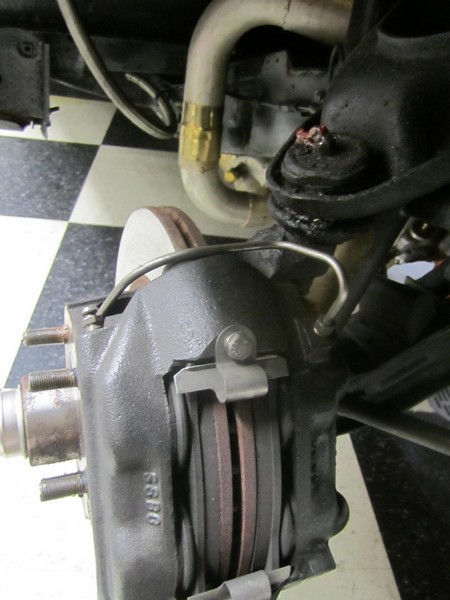

I bought the front kit from SSBC and am VERY happy with it.Installed a few years ago,everything needed was in the kit right down the the cotter pins.I have no problem stopping 3900lbs when I turn the key off at the finish line.They are manuel brakes,no fancy rotors either. So I don'y know who had problems with what,but I bought the kit from SSBC and I'm a satisfied customer.
I also put over 2000 miles a summer on the street with NO problems.
