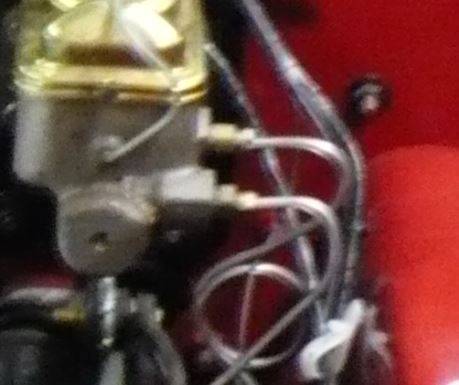

There are several different size fittings, master and distribution block. You can buy adapters for master to regular brake line fittings. Be sure there is enough thread so they seat in master. I bought some an ran out of thread before seating. Blurry pic but you can see adapters .
