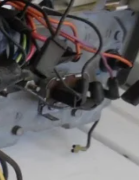

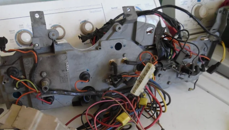

I found this photo online which shows the hard plastic cover over the power wire to the voltage limiter (the connector to the left of those soft rubbery ones). No easy way to make it fit any tighter.

Yes, a plastic one with regular female packard terminal goes to the U shaped male terminal shared to the condenser. That’s the powered one coming from fuse box.
There is a wider one which goes to the chassis/bracket ground prong. Very important, because without a good ground, gauges can burn since limiter will be inoperative and full 12 volts will be going throught. Althought still without that one some ground should be get throught cluster housing itself once cluster is firmly attached to the dash frame (and limiter is screwed in tight againts cluster housing)
Pretty sure the one loosen on pic with black wire is that ground

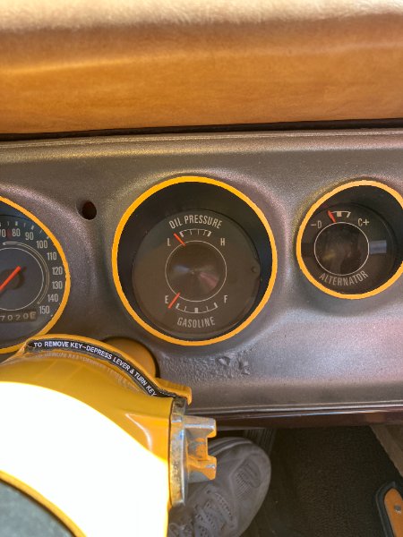

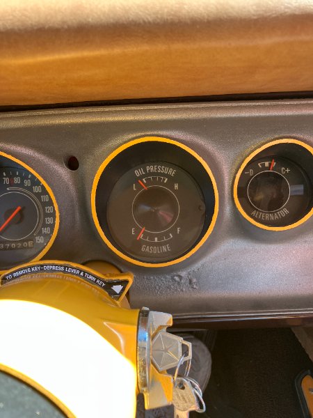

Update: I was able to remove the plastic cover from the voltage limiter wire and squeeze it closed a little bit. Now it seems to be tight enough to stay on. The coolant temperature gauge is now working but not sure about the fuel gauge. It does move a little bit but still below the "E" mark. It could be that the tank is almost empty and the gauge is working. Photo #1 key off and photo #2 key on.
And one will notice with key on (engine running) the converted ammeter gauge (now a voltmeter) shows a charge but with key off shows a discharge. I disconnected the battery ground cable and the voltmeter stayed in the discharge zone. Going to contact Redline Gauge Restoration to ask if that is normal after their conversion. To be continued ...

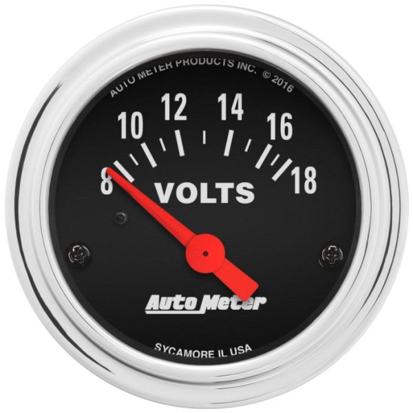

The conversion is probably correctly done, just scale or gauge face is incorrect/unmatched. The scale on an ammeter gets the ZERO in the middle, then according with where the load comes or goes, will show charge or discharge. ( - or + )
On a voltmeter, the “ZERO” (well not allways a Zero but the smaller value on scale… tipically 8 volts) is on the left end and will sweep like any regular gauge. There is no minus or discharge reading on a voltmeter.
