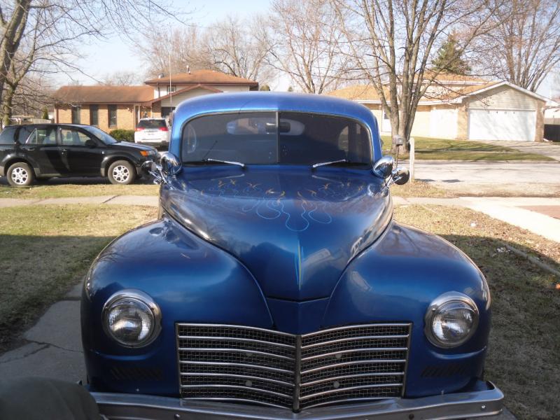

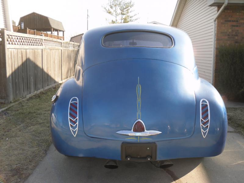

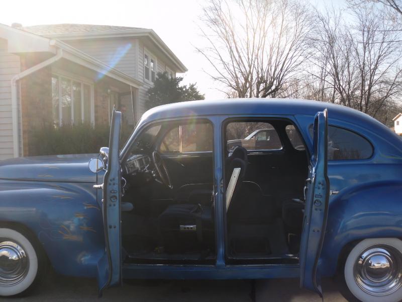

You guys wanted some pix, so maybe I can get them to attach. The car is all Mopar except for the interior and steering column. I built a trailer hitch and we towed a camper to a gathering about 250 miles (one way) away from home. The show is the "Frog Follies" in Evansville, Indiana. Neat show! They don't allow anything newer than a 1949 car or truck. About 5000 attendees - WHAT A HOT ROD GATHERING! Lot of fun. This thing is an addition to my 2 B-bodies and one A-body. ( the wife drives a 65 Mustang convert. - Haven't gotten her to see the light yet). SDC11524.jpgSDC11525.jpgSDC11521.jpg
