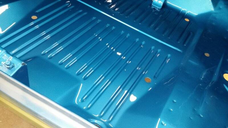

Sweet photos!! Looks great. Mine is going tomorrow for blasting do in pretty stoked. B5 blue with black vinyl top
