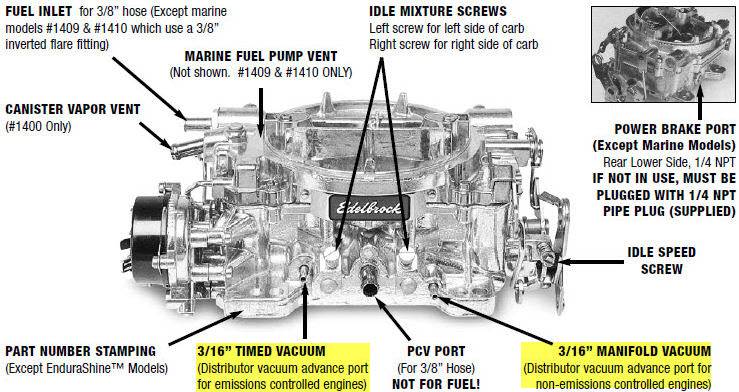

I have a '71 340 with a Mopar electronic distributor and an Edelbrock 1411 750cfm carb. I'm hooking up the vacuum advance, but I'm not sure if I should hook into the "timed" or the "manifold" vacuum port. Any ideas? Thanks guys.

I used timed on two motors without issue. I get my higher initial/total from the distributor so I don't have to rely on the vacuum to do the same thing.
I also am using timed, my 750 eddy had a surge at higher rpm , With help from guys on here and a spring and rod change along with a smaller advance plate & using the timed port cured the surge.

the factory port is above the right primary throttle blade. this position goes back to pre-emission days.
Timed port is above the throttle plate, thus no vacuum supplied at idle (an early attempt at emission control), while manifold supplies vacuum at idle. Once off idle, they're both the same. I run mine (same carb) on manifold vacuum.

Timed. The distributors aren't set up for constant vacuum.

No, it really doesn’t. Other makes used full time vacuum. The type of distributor doesn’t matter.
If everything is stock, use the ported vacuum.
Manifold vacuum is used primarily for a performance engine with an upgraded camshaft but requires a re-curved distributor.

Well, it does have a slightly upgraded cam. Just a step above stock.
the vacuum advances are adjustable. use a 3/32" allen wrench in the nipple to adjust. clockwise brings the advance in sooner, counterclockwise delays advance.
