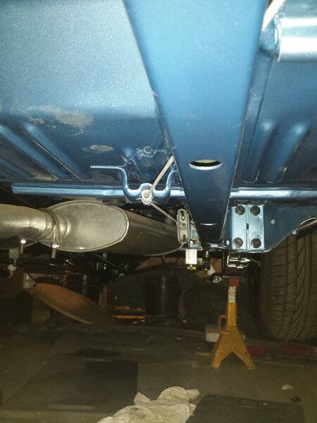

when i did mine back in 77 we cut the floor and made the connectors out of 2x3 square tubing then welded the floor back to the connectors very stiff. then we cut another piece of square tubing and welded that from the connector to the main hoop of the rollbar
Nice job! Those 2x3 steel connectors look awesome!
