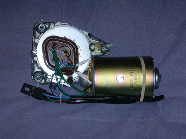

Seems like most 68 3-speed motors are the half black can style.
Did the gold anodized barrel style start in late 68 model year (spring/summer 1969)?
Seems like most 68 3-speed motors are the half block can style.
I've seen both styles used on a 68.. My 68 440 R/T is a fairly early build 9/67 and it has the newer style motor...
