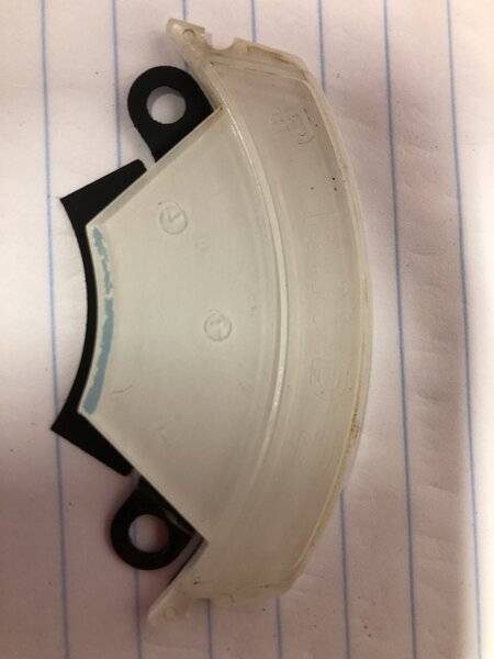

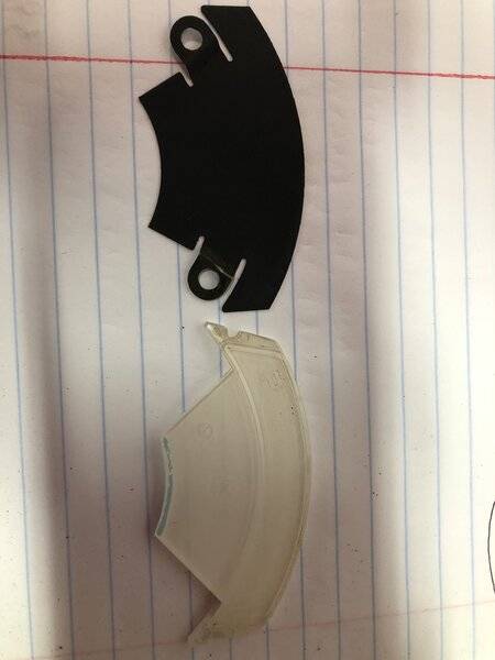

My paint behind the gear indicator letters (column auto) is flaking off. Its white, but I am afraid to just touch up with regular enamel because the stuff seems to be some kind of special luminescent paint to glow from the faint light from a tiny 1445 bulb shining thru a pinhole cover.
Any ideas as to what to use to touch this stuff up?

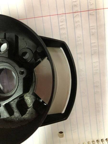

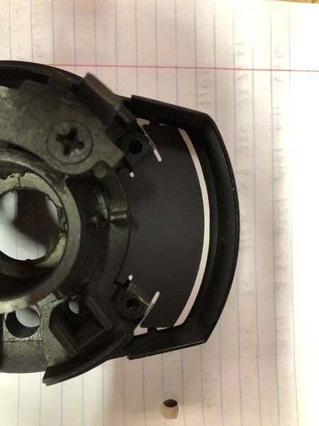

The light does not come through the paint. It is from the front into the lexan, so the key is that the white is bright and solid so the light does not escape. The white is covered by a black plate. These pictures should help you see what I mean.
I used a standard spray paint on mine but have not installed it yet because I need to put the PRND12 back on, mine totally faded away as you can see.
I hope this helps.
RGAZ
Anybody ever get an answer to this? I spent about 20 minutes here at Home Depot looking for a paint that might work, but nothing seem to fit the bill
Dont rule out a pearl finish white nail polish .
Paint the backside of the piece
Yep, just a bright white. Like a movie screen - you want a max-reflective color, but non-luminous. Plain ol' white. And paint the backside of the lexan, so the lexan can carry the light across the face.
