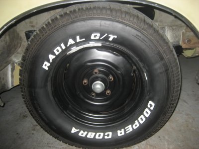

I hope the above works for raised white letters as well. I just bought new tires and they say not to let the black walls touch the white lettering. Tough to get the black off the white lettering. Too late..... Need a recipe for cleansing.
I started using bleach-white because the BFG's I bought had some brown/yellow color to the raised white letters, and I wasn't happy with how they looked. I first used it with a clean towel and it did pretty good, but the rear tire letters were more yellowed, so I then used it with "0000" steel wool, and they are now bright white!
Just a note about using fine steel wool - if any tiny particles of the steel are embedded in the white, it's possible for them to rust and leave a brown spot. Better to find some stainless steel wool, or use an abrasive like a scotch-brite pad.
That's a good point, and I thought the same thing, so I inspected the lettering under magnification to make sure nothing stuck in them. The scotch-brite pads turned the letters green when using with bleach white, so I opted for the super fine steel wool. I think next time I will try using a magic eraser with the bleach white, but hopefully now since I have removed the yellowing and dark marks, they should be easier to maintain white.
Interesting ...., I have used Brillo pads on my white letters for years and have never noticed this happening. :eusa_think: ( ...but I do go back over them with the Bleche White)
As a kid of the 70's/ 80's I lived by ArmorAll, until a buddy showed me the results of a good General Purpose cleaner like Simple Green, and a quality scrub brush. I now use 'Purple Power' due to it's citrus base and better smell. Anyway's, no product afterwards, a lot LESS effort, and they look like, well...brand new white letter tires when done.
I've used good old SOS pads for years on whitewalls and white letters, works great.

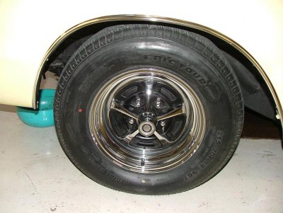

Success! Thanks to Sonny Black, I used lacquer thinner on a rag on my goopy tires. It cleaned everything up great and very easily and left a clean matte surface. I still have to find a good "tire black" but now have a great surface to start with.DSCF3059.jpgDSCF3060.jpg
So after this I'm wondering if 'Antiozonant' is just salesman BS ?
Sonny's tip with thinner would seem to fix any problems with cleaning the tyre surface.
And I have yet to read anywhere where a tyre is leaching out Antiozonant.
