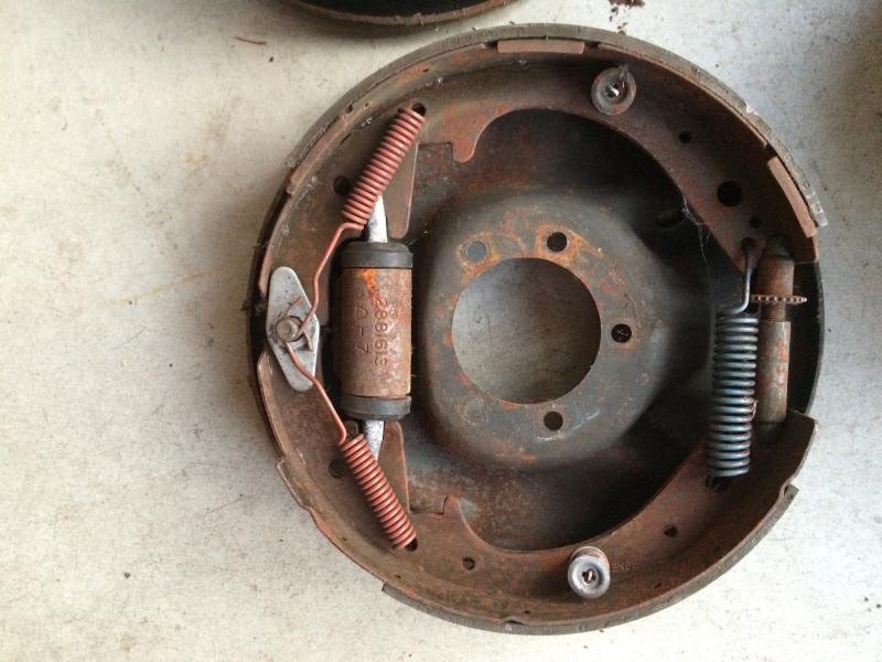

I am new to the Mopar scene. I got this set of drums with the car, and Im trying to identify what they came off of. It wasn't my car because mine came with 10" drums originally. These are 11" rear drums. Shoes are 2.5" wide. Seems like there are some parts missing. No strut w/ spring. No adjusting wire and hardware. Any ideas?

Well, several cars came with 11" brakes but that's not a drum....it's a loaded backing plate and yes, it has several missing parts.
I have basicly the same rear brakes.

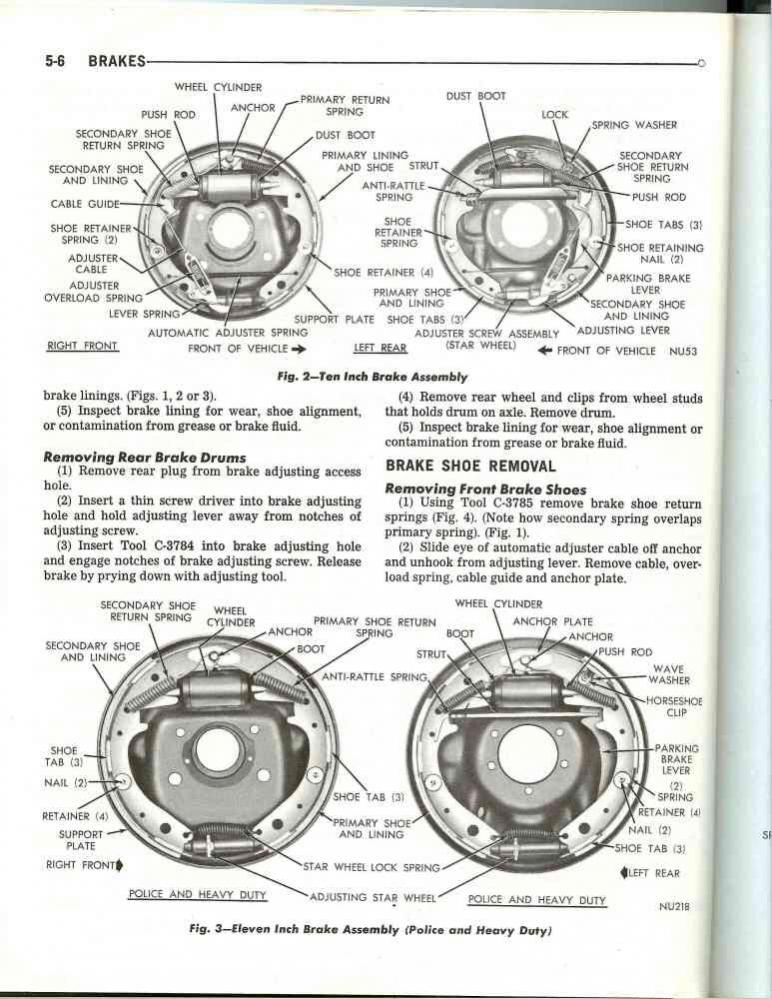

No strut/spring because it's set-up like police brake option. The difference is manual brake adjustment only.

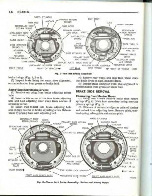

You can look it up in the SM, that shows both set-ups. I added the self adjusters on mine.
My mistake, I should have said rear brakes. Thanks miller!

Sure! Those things are made for a few different set-ups. Your's is missing the parking brake stuff.
