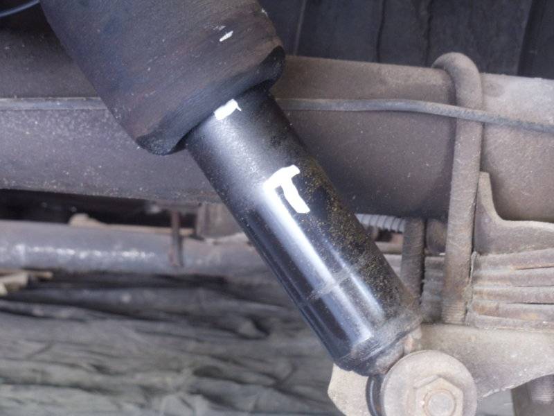

I have air shocks now as an interim measure. The top of the "T" in the foto is the line where the shocks sit before they are pumped up.
