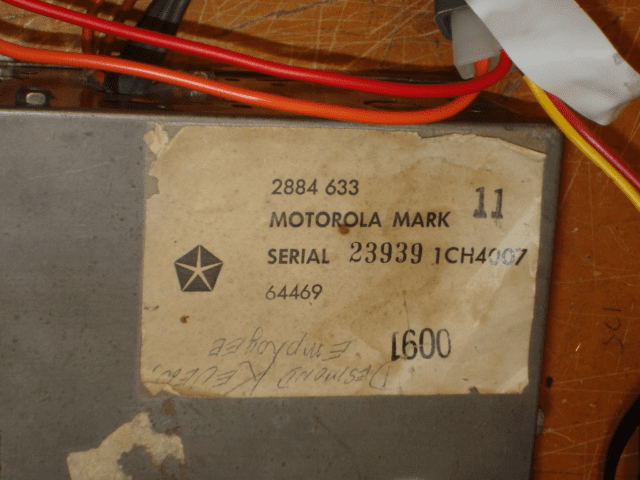

Motorola AM/8-Track here for the 1970 GTX
So that was for Desmond Keven. And he got the employee discount.
He was the Kiwi guy who was the second owner, and brought it out to New Zealand in 1973. My good friend here @super-bee_ski was able to meet up with him over a year ago now, and present him with a 1:24 scale model of the car.....in Las Vegas.
I also sent a couple of NZ Hotrod newspapers for the guys to read....
Thanks Mark. :thumbsup:
