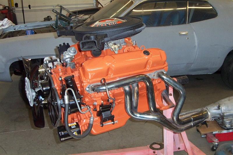

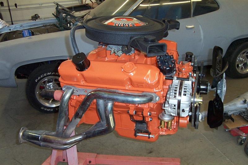

Here are the mounts your need.
Here are the mounting brackets from 440 Source.
