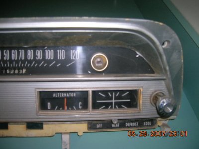

This is the one we had sent to them (before rework :icon_winkle:)

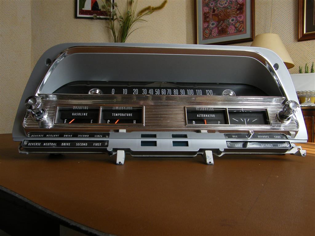

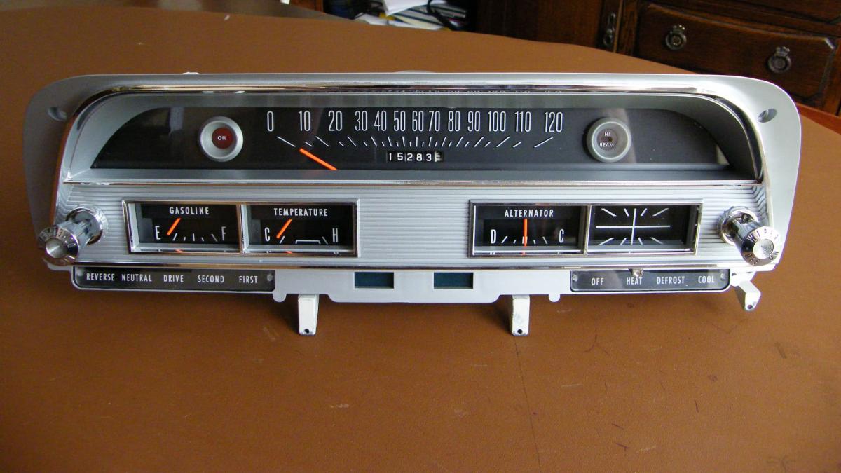

And this is how it came back. Great quality, but as i say, not the same finish as i was expecting due to there being 2 different finshes apparently :icon_rolleyes:

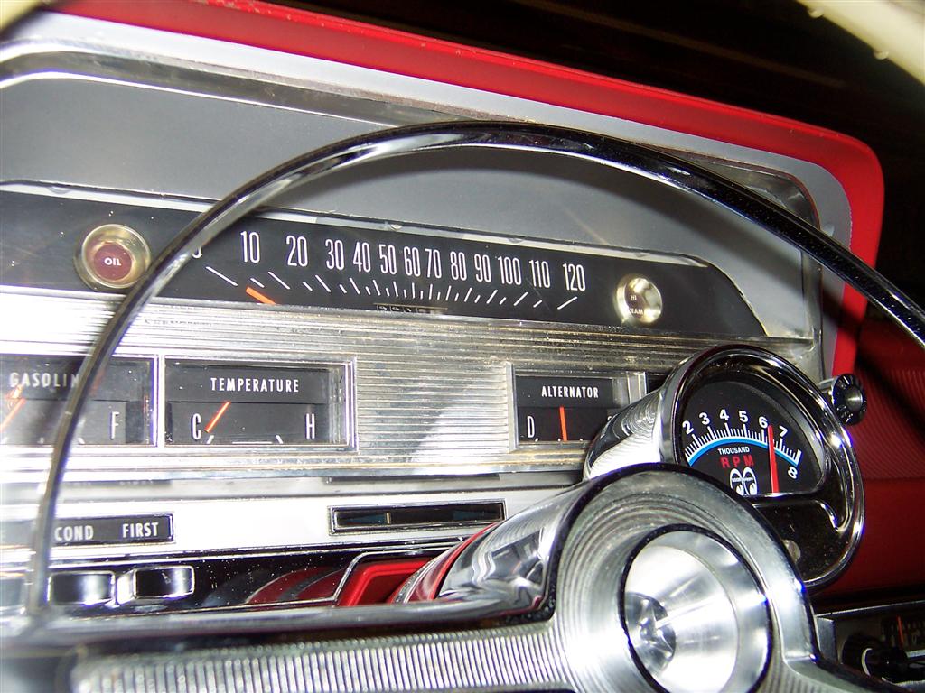

And here's our original, still in the car. I looked at as many pics of other 63 clusters as I could find on the 'net and there did seem to be a mixture of painted & chromed examples, but mostly chromed like this one. The area I'm referring to is the 'ribbed' bit just below the speedo

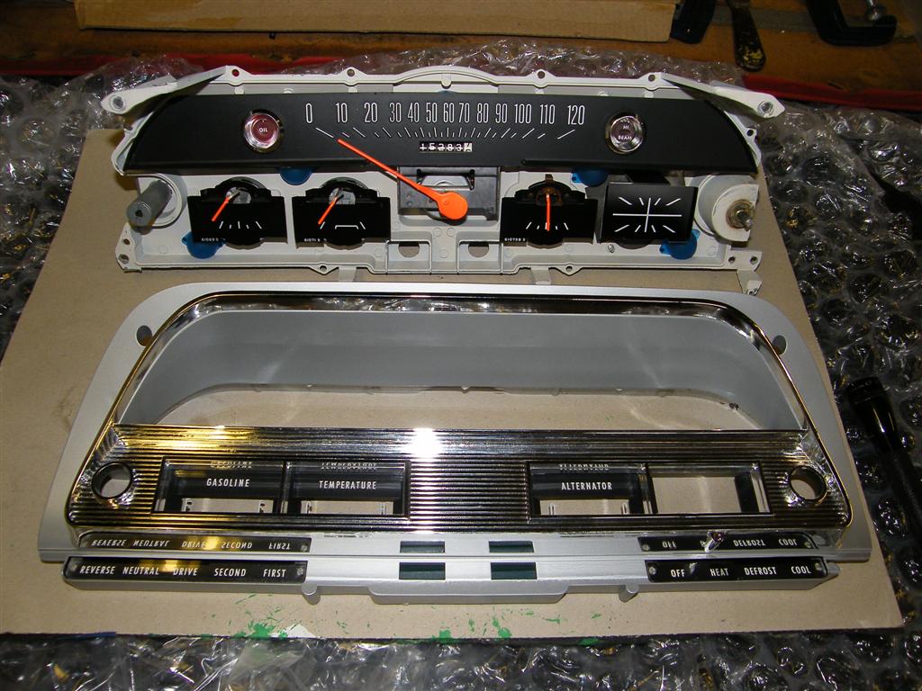

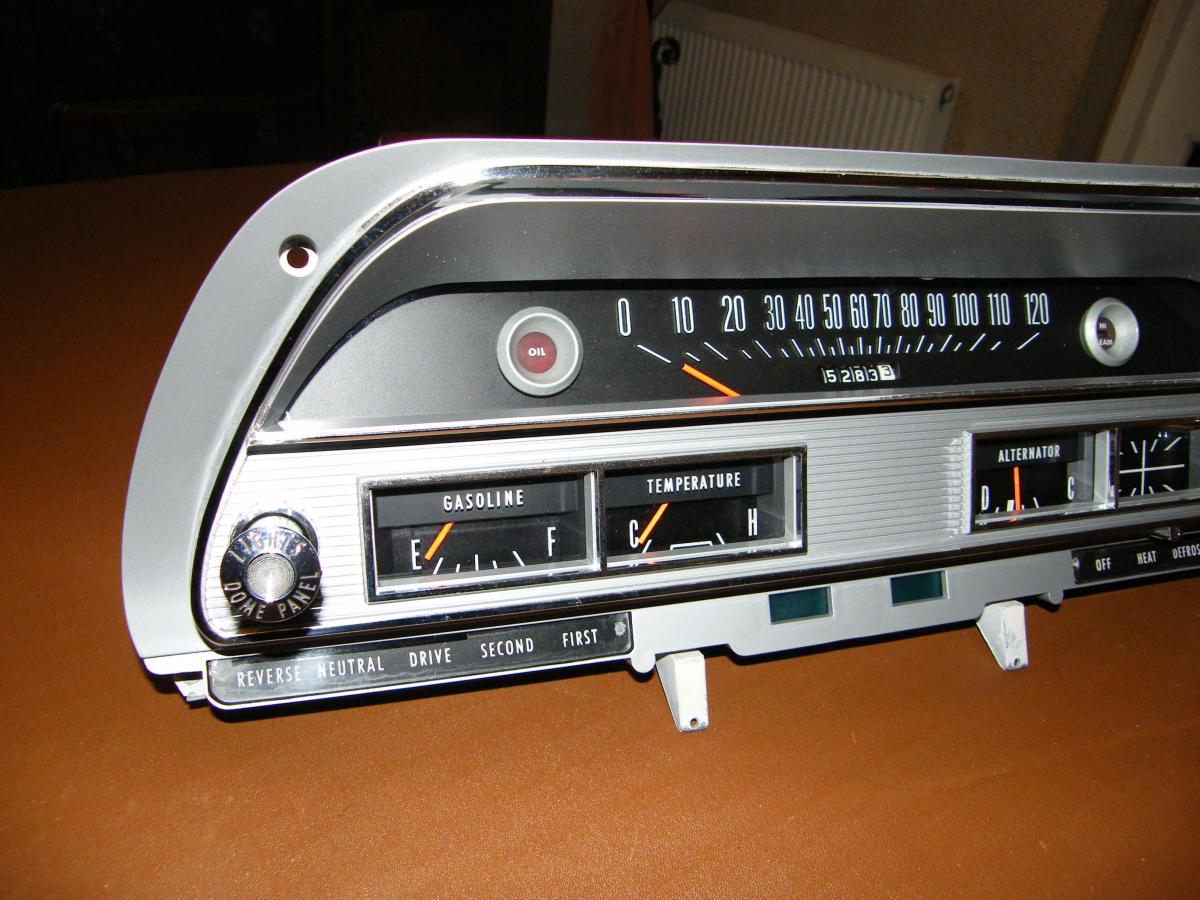

and finally... here's how it came back after autoinst reworked it for us f.o.c.
Very impressed with the service & quality :yes:
Ooops…I hate to have to say it, but the error was yours and not theirs.
The reason why the ribbed area on your bezel appeared specular ("shiny") rather than diffuse ("matte") is because the frosted clear topcoat flaked away over time, leaving the bare vacuum-metallised aluminium exposed and making you think it was supposed to look that way. The matted-chrome finish on horizontally-ribbed plastic design was widely applied on '63-'64 Chrysler products; one sees it also on the '63-'64 Dart, the '64 Valiant, and others.
Originally the whole bezel was metallised, then frosted and clear topcoats (and blackout paint, in some cases) were selectively applied. The unfrosted clear topcoat was used very selectively and only on small areas that couldn't create a dangerously distracting sun reflection into the drivers' eyes. This was a matter of Chrysler's corporate instrument cluster design philosophy, described in some detail in two 1962 SAE papers, one of which you can buy directly from SAE here. The other might be out of print; I'm not finding it in an SAE search but will likely come across it in my own collection sooner or later. I have heard more than once, from those who were close enough to be getting accurate info at the time, that one of the major drivers of this bit of philosophy was the 1960-61 Valiant instrument cluster bezel, which had a specular (non-matte) metallised aluminium "chrome" finish over its entire textured surface. This caused a fair bit of squawking due to brutal sun reflections; the '62 Valiant cluster bezel was almost entirely blacked out, and the '62 Lancer bezel had most of its chrome area matted.
So…props to Auto Instruments for reworking your bezel at no cost, and your bezel certainly looks nice, but I believe you have insisted on it being "restored" to an incorrect finish.
