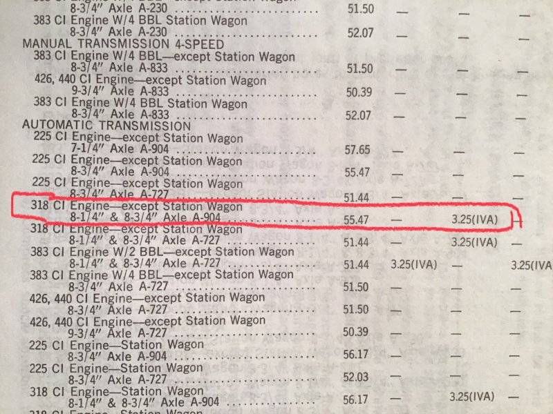

The 1970 Plymouth service manual has a chart of driveshaft specs for all the different cars/engines.
I would have the large 7290 on the driveshaft and use 7290/7260 combination u-joints. If later on you want a more powerful engine you upgrade the yoke.
I believe it’s a stock resto so no need for for big joints.
here is the service manual list
