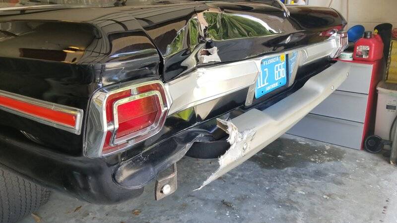

Who sells new1965 Plymouth Belvedere II deck lids ? And, All of the pieces damaged here.
The deck lid isn't available new, you'll need to go find one. Looks the same as a '64. That should increase the pool. Bumper looks like a '64 too, AMD has those. Other metal, it's you and the hammer unless you get lucky and find a donor.
Do you mean a fiberglass Deck lid? I see the glass bumper on there.
64 and 65 trunk lids aren’t the same, neither are the bumpers. 63 rear bumpers are the same and 63 trunk lids can be made to work by filling some trim holes and drilling some others.

Thanks! Good to know. They didn’t do us any favors did they?
The only reason is that the taillights are wider on a 64.
