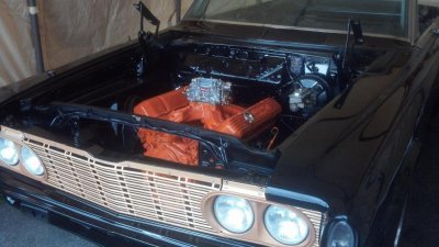

Sounds Killer, Will it fit my 63 Plymouth Sport Fury Vert. ? How much is the Kit ? 17.jpg
