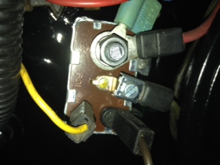

Sorry guys its a 68 gtx 440. I did not want to tap into the hot side of the fuse box 440+6. Yeah I see the wire your talking about 69 runner (think its gold, brown down to starter on my car ). I just wonder if I did not have the key turned far enough ( run position you say) to get the wire hot going down to the starter. I have schematics. I will go back out and check that. Thanks. O.K went back out and turned the key in all positioned. I dont see a hot going down to starter when key is turned on (checked with meter ) Here is my relay. Checked all the contacts for 12v when key turned.
I posted a pic for you of the starter relay. What am I missing here? thanks.

I don't think the starter relay is the place to connect, none of those points are hot only in "on", either hot all the time or when key is in "start", the 4th is ground to neutral start switch.. The best place to connect is the side of fuse box that's hot when key is "on", & use an inline fuse of appropriate size for the fuel pump you're using.

When the key is turned all the way to the right (start) then the yellow wire is hot, which pulls in the coil. When you release the key it's in run, the starter disengages. Don't you want the fuel pump to run at all times while the key is in RUN?
