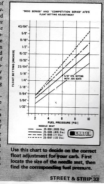

Carter/Edel carbs will quite easily tolerate 10psi of fuel pressure, but the float level must be reset....because fuel pressure changes the fuel level.
The 426 Max Wedge fuel pump was rated at 6-8 psi & the Carter AFB carbs used exactly the same n/seats & floats as other AFBs.
