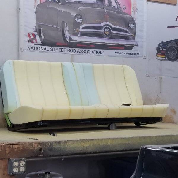

The original automotive grade foam found in the original seals is completely different than the current automotive foam found the reproduction seat foam. The original material is much more dense and has a slicker exterior finish to it than the current pieces. For the molded bucket seat foam sets that are available, the tooling to do these pieces are huge. When you start to getting into items of this size, the pricing and the ability to do larger pieces just becomes crazy as compare to smaller simplistic stamped or molded pieces.
When you have to start creating custom sets for those that are not available, just like any fabrication skills, it takes time and experience to develop those skills which usually means more dollars. Also check around on pricing. Most of the larger vendors are sourcing from one manufacturer and repackaging the product with their branding.
Some of that money goes right back into R&D for other reproductions so they can support other missing products and expand their product line.
