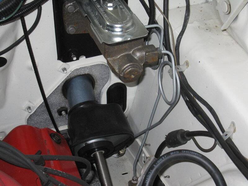

As you know it has the single pot master cylinder for the drums. Can I just get the 67 and up dual master cylinder and proportioning valve for the stock drums? I just want to know if it's a direct bolt in. I'm not doing the disc conversion because it's just a stock tired 273 2bbl. so hot rodding is out of the question.
You don't need a proportioning valve. Just split the front from the rear lines. Rock auto was cheaper for the dual master than a single too. I can lock all 4 if I stand on the pedal.
Mike
And the 67 dual will bolt right in?
Maybe upgrade with someones 11" take off drum units if you are going to stay with the drum system. OE look with more whoa.
No upgrade. They work fine. Once I'm ready to upgrade then I'll go disc but I have another project that needs the money first. Discs are a couple of years away.
I have that same master cylinder almost new if you want it PM me.
You can also find a line kit with the valve pretty cheap on e-bay.
There is a splitter block on 67's not shown in Mike's pic.
They are on ebay.
I didn't use a splitter block I just plugged the rear port and spliced the rear line to the new master front port. I formed the new lines myself.
