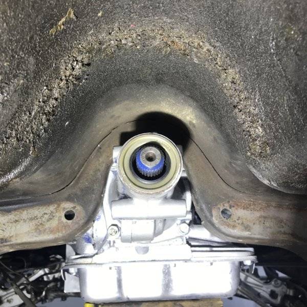

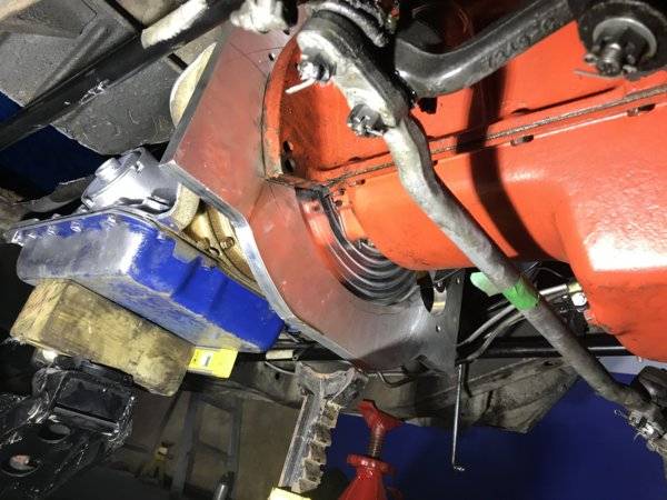

just began fitting my 700r4 on my slant six, not to much cutting of body

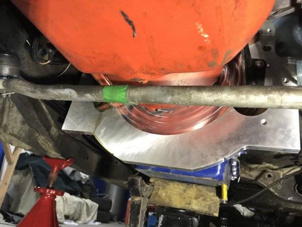

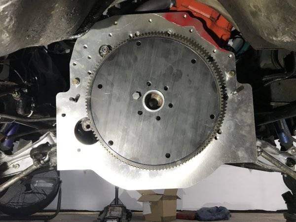

the trans lines up pretty good , just have to make a proper mount now.

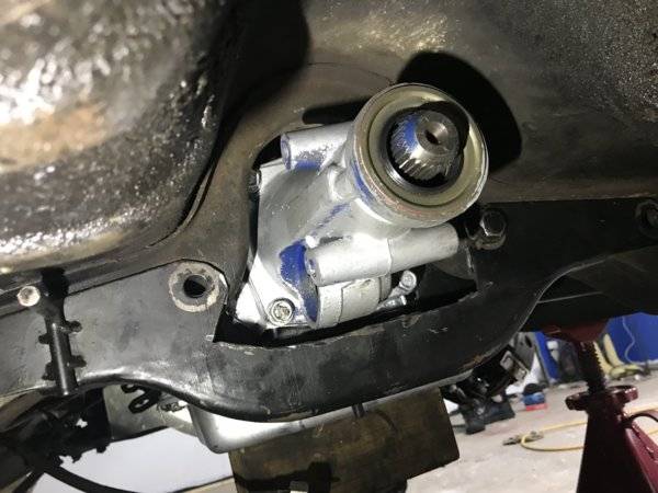

the speedo looks like it will a bit of a issue but i ill see if i can get a 45 angle to make it work better if not going to cut some more .going to add frame connectors too.
not looking forward to trimming the aluminium back plate , they make it like that and cut what off what you want
