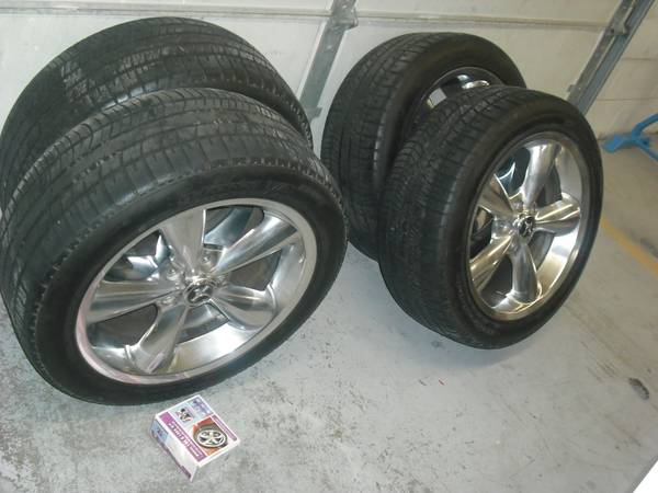

I'm just curious I saw these on sale near me and wonder if they would fit on my 1970 Plymouth satellite..
I know you might need spacers reading other posts.... but they mainly talk about 17 inch Mustang wheels..
I'm just wondering if it would be an option.
This is a link to the wheels
http://washingtondc.craigslist.org/nva/pts/4295286114.html
The guy said they came off a 2009 Mustang... I looked over on the A body forum they talk about hitting the control arm with 17s but no mention of the 18
the wheel you have pictured appear to have a serious positive off set,some times called fwd offset.that will put them way in towards the frame and will still prob hit the control arms even with a spacer.you can only go about 1/4 inch safely with a spacer and you would prob need an inch or more to run those.
stud pattern will fit, find what BS they are most mopars require around 5-5.6" rear BS and 5" BS for the front and this is with a 10" rear rim and 8" front rim, roughly. If not you will need spacers, which I believe are illegal or at least should be as they can be very dangerous if not done or used properly
wheel spacers are far from illegal. they are used in numerous applications and sold by the thousands.
this can be done but you are going to need at least a 2" spacer. I would hold out and just get wheels that have a shallower back space. the spacers alone will run a couple hundred bucks.

Even a 1" spacer will pretty much make the stock lugs useless....

You need a thick enough spacer to return the wheel to 0 offset. Most spacers of this kind are the bolt on variety. These are the only safe spacer variety. Lots of guys run them hard. I autocrossed on 1" and 1.25" spacers. There very common on the 4x4 market. Properly installed, they don't loosen, just like rims. Just check the torque after a few miles when first installed. 18" wheels don't have issues with the lower ball joint. It also comes into play when the backspace gets over 5" IIRC. A bodies can't fit as wide rims as B-bodies can.
