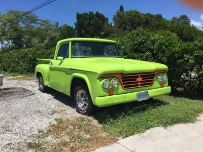

going to look at a 1962 d100 flare side with a poly and a four speed manual. would a 440 mount to that trans. no numbers on trans till i get a look, but effects my cash offer. guessing a new bell at least d100.jpg

Not for me but a ok truck . dude ruined the hood this morning (forgot to latch it two bolts pull on each bracket creased it all across , lucky he didn't bust the glass) 1st 2nd gear forks shot , side rails has cancer. poly is tired. maybe someone else would be interested . he is spooked with the hood flip at speed and a gas leak at the fuel pump , probably take a verry low offer. http://sarasota.craigslist.org/cto/5245595546.html
